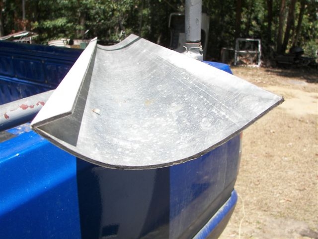

Here's a material I'd like identified.
It is two sheets of what appears to be hardened aluminium
sandwiching what appears to be Laminex.
I have several of these 'found at the dump' items and am looking to make a set of blades from them.
Any clues??

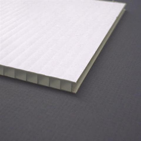

Hi Glenn, I think the stuff you were asking for is called corrogated plastic some brand names include Correx, coroplast, coreflute, corelite, fluteboard and twinplast.
