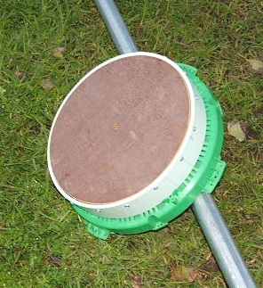

Picture 1 Shows the 7mm cut in the 41mm pipe with two extra bearing for blade support. Once the innards are removed the PVC pipe fits tight.

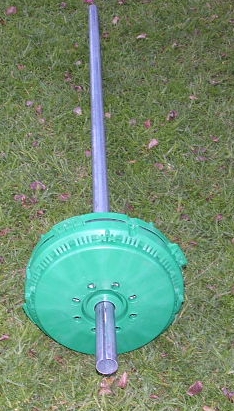

Picture 2 Shows the Seeley mounted. It is quiet heavy.

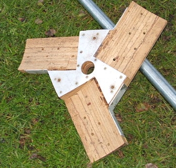

Picture 3 Shows a mount assembly which is to be considerably reinforced.

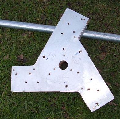

Picture 4 Shows the front of a blade mount which will have a Seeley bearing mounted on a steel plate and not aluminum as shown. Note the alignment of the leading edge of the blades.

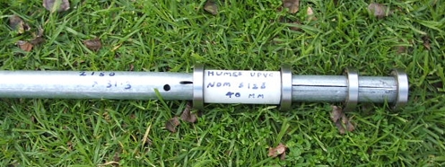

Picture 5 Shows the back of the blade mount which will have Seeley bearing under a steel backing plate. I have found a pipe with a perfect fit to the OD of these bearings.
