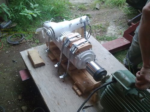

PS
This my test unit.
I have 15Kw electric motor and 20kw frequency changer..
I have made many adapters, to suite any wind generator, with rubber coupling etc
We have tested and made many, controllers, with this.
All this, with my own money, not to make any busines, but for all of us !
We need OPEN code, for these solutions !
In the picture, 2kw Huayaturbine wind generator in the test bench;
