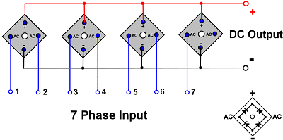

Question that has just dawned on me..
If i direct connect from the Bridge Rectifiers on the F&P to my battery bank, and then my mill slows down so much that it is no longer creating usable power, wont the battery bank feed back into the lower voltage @ the F&P ?
Is there any inline diodes / something that I should use to make this one way traffic only ? or am i wrong in my assumption ?
Steve
Highlander
Joined: 03/10/2006
Posts: 266
Posted: 11:01am 19 Jun 2007
As far as I know bridge recs are one way diodes put together in a nice little black package.
pic courtesy of Glenn
correct me if I'm wrongEdited by Highlander 2007-06-20
