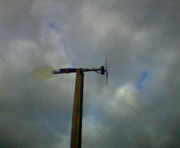

finished building a minimill as per the web site instructions, got it up in the air, but as usual no wind since I put it up.

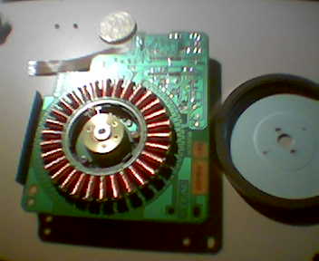

Had a look at the other motor in the FDD and thought it looked a bit like a f&p / sealey, thought I might have a go at doing something with it..

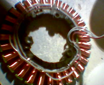

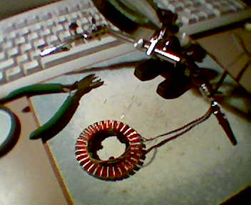

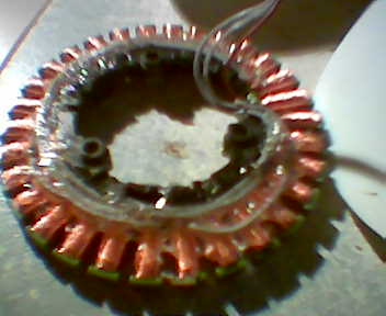

pulled the board off it, and started to rewire it to star config..
bit of a fiddley job, yes that is a magnifying glass, eyesight not as good as it was...
got to practice my soldering, bit rusty tho, slaped some selastic on it

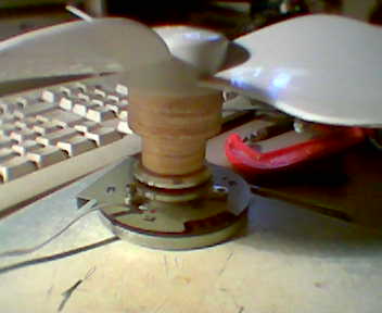

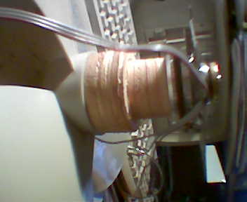

Made a boss for the fan blades out of a bit of pine,

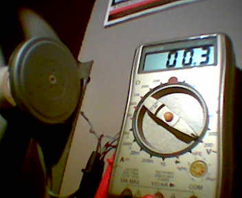

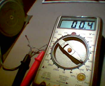

and spinning it by hand can ger 0.6 volt AC out of two of the 3 wires( not quick enough to capture it at 0.6, only got it at0.4 and 0.3 volts
will get a bridge rectifier or 3 and see what it will do, well that waisted a day or two, will keep you all posted when I finish it.

Hi glen, did run it as is, got 1.3 v ac, thought I could improve on it, well we will see when I get a dc output.
