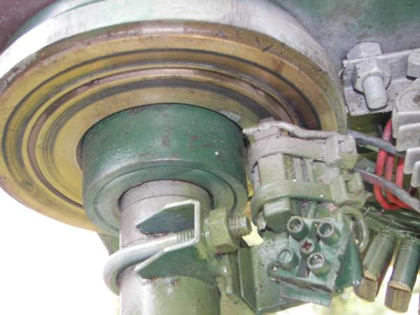

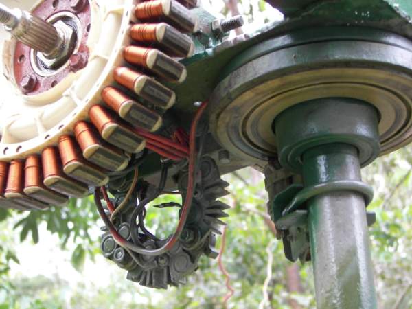

My first mill uses horizontal slip rings
Yaw pivot is trailer stub axel and hub which suits this slip ring setup.
Others pivot types suit band style rings.
Good luck which ever way you go.
