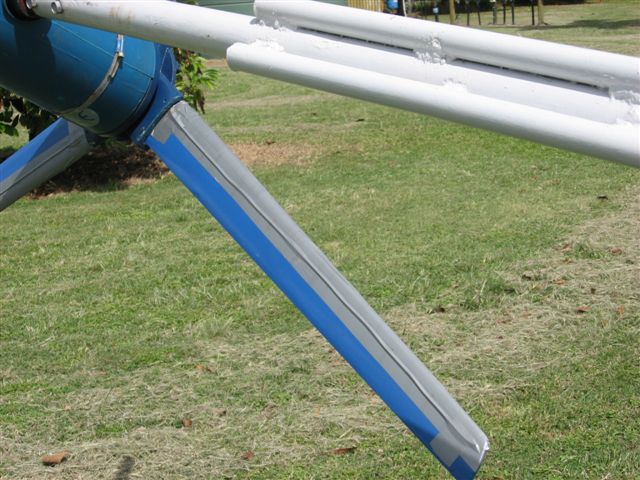

Mod 1 is to use some sticky take to extend the tail. The idea is to get rid of that horrid rounded tail and create a sharp tip. The tape could extend about 5 to 10 mm past the tip.
Mod 2, which I read about yesterday on this link http://www.fieldlines.com/story/2007/3/28/205619/172.
This guy had a set of blades very similar to the chinese blades, but these had a ridge on the back which he sanded off. They then made lots of noise. So he figured the ridge must have been there for a reason and he made his own ridge with a length of fine wire and some sticky tape. Apparently it made the blades dead quiet!
If you have the time, it might be worth while giving these mods a try. Its only sticky tape, so easy to do. Wouldnt last very long in the weather, but would be ok to prove an theory.

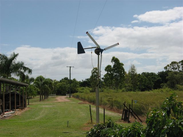

Got a chance today to try the mods………….won’t bother with mod1.
Mod 2 is the answer………..all that’s left is a slight whisper, only audible directly under the mill……..now virtually silent even at 300-400 plus rpm
Bit rough and crude all I had is 2.5 weed eater nylon and cheap duct tape.
The extender hub is now on a 3.2m pole with a decogged standard 100s………sits on a pleasant 5-8 amps all daylight and self starts in low wind

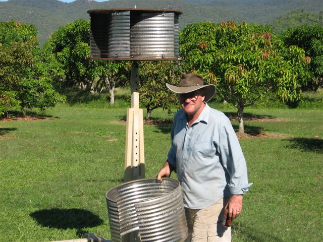

Have also included a picture of a six bladed vawt using the stainless steel drum pieces from an f & p ………goes quite fast and starts when you breathe on it.   The drums are awkward to handle with the cheese grate finish but definitely are very strong light and cheap. Will increase to 3 tiers and direct couple a low power f & p to see what I can get.

As I ‘ve got 2 sets of my own blades to modify I will be interested in a permanent method of ridging. I assume that fibre glassing something onto the back of the will be the answer ………..maybe if you are talking to Trev , he might have a simple solution?
David Warren
So it looks like that ridge down the back is the fix for these blades. Just need to get our resident fibreglass guru ( Yeah you Trev ) to tell us the best way to make a permanent modification.
