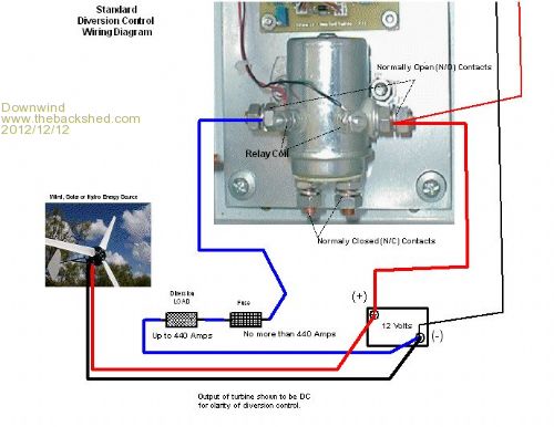

Hi,
I'm battling my way through making a board and connections, to batteries from a 500 watt max wind turbine, a controller, 600 watt Resister, 50 amp circuit break, 4 AWG Wiring and still not clear on a couple other things. Want to run it by a couple of you more experienced so I don't stuff things up.
This is all installing in a shipping container and the Turbine mounted on the top! Might be able to get a photo up in a while but first bit of confusing is as follows!
I've bought the resisters and the 440 Amp 10,000 Coleman Air Control Box as in this link which has all connection illustrations and explanations, Coleman Air C440 . Just still a little confused after reading the instruction leaflet sent which is the same as the link info above!
It illustrates to connect a negative "loop" wire run from the left negative in the Control Box (from the Soliniod.. I think its called.... it has a big nut coming off of it on the left side of it!), then through a Fuse, to one side of the resister then a connection from the other side of the resister down to the negative on the Battery. In the illustration in the link, this "loop" is marked all Blue!! Not RED or BLACK???
Question is?.. why is this so?... why both negatives? wont the resister need a positive to dump the load, or does the negative line coming out of the Box switch to become a positive line when it needs to dump excess power to the resister?

Posted: 03:11am 12 Dec 2012
Ok, the blue line is the main switched positive feed to the dump load. the whole dump circuit wiring is shown in blue, due to the fact it makes no difference which terminal of the dump wiring goes to what, as long as one end of the resistor connects to the battery V- and the other wire from the resistor connects to the bolt on the solenoid.
When the controller activates the solenoid V+ is switched to the dump load, completing the circuit and applying power to the dump resistor.

Posted: 02:08pm 12 Dec 2012
Thanks so much for explaining that out! You've even uploaded a diagram.
OK, so that is the function of the Solenoid. To Switch the blue line over to run in +Positive feed.

On connecting it all up and using batteries well undercharged and testing the whole system under wind, the controller instantly makes a shuttering noise, lights red and I'm assuming is dumping. This effect is recurring and does not seem right.
Any suggestions what might be going on here?
I thought maybee the two smaller bolts on the front of the Soliniod may have came to me from the manufacturer wired incorrectly? I am only assuming this but I do not actually know yet!
What I can say is the right small front bolt has one small wire going to the 12V+ Coil at the "top" slots, IN screw slot (the second slot in from the right at the "top"). And the left small front bolt wire goes on the left side marked 'Relay'.
Posted: 11:38pm 12 Dec 2012
Daniel,
From what you say its likely the battery you used was dead, and when the circuit switched the dump load on it dropped the battery voltage so fast it put the circuit into a ON / Off frenzy, this would also suggest the hysteresis is incorrectly set, meaning the voltage difference between when the circuit switches the dump load on, and the voltage the circuit switches the dump load off at.
The shutter noise is what we call "relay chatter" where the relay (or solenoid as you might call it) switches on and off at a fast rate, this is BAD, not what you want to do with any relay for a extended time.
The problem is the window of hysteresis settings is far to close together, for example if the circuit switched on the dump load at 13.8 volts and switched the dump load switches off at 13.6 volts, the draw on the battery would instantly drop the voltage below 13.6v meaning the circuit would switch off the dump load, then the voltage of the battery rises due to no load and the circuit switches the dump load back on ........RRRRRR-Repeating.............hence the fast on/off relay chatter you hear.........BAD!
Guessing this is a 12v system using wet lead acid batteries, try setting your hysteresis voltages to 14.2v dump load on, and 12.8 dump load off, this should give a reasonable window of hysteresis to not cause relay chatter, it should be ......CLUNK....... relay on............. waiting........ still waiting.......... CLUNK......... relay off, ..........not BUZZZZZZZZZZZZZZZZZZZ of relay on/off.

If you look at the bigger version (where you can see more of the upper part of the image) in the link of the same image as above, it shows a 12v wind turbine connection illustration. My wires coming out of the two smaller bolts going to the top are back the front! It has the same illustration in the instruction leaflet that was sent out. My controller is wired back the front to that. Its the two tiny looking black and red wires running up to and screwing in the top of the circuit!
Have we ruled this out as not being the problem? Edited by Jaffasoft 2012-12-14

A relay is a uni directional device (can work either way ) with 2 parts, a coil and a set of contacts. the smaller bolts are the coil, the larger bolts are the contacts in your case.
So as long you have the smaller bolts (coil) connected to where one or the other is shown on the drawing, regardless which smaller bolt goes to which wire (its unidirectional) it will work.
The contacts are also uni directional, its just 2 surfaces that press together to close the switch, it makes no difference what wire end goes to which of the 2 larger bolts.
How a relay works is the coil (smaller bolts) creates a magnetic field that pulls the switch contacts together (larger bolts).
This allows a small amount of energy to switch a much greater amount of current, while isolating the controls from the contactor voltage.
[quote] Have we ruled this out as not being the problem? [/quote]
Yes we have.
Take a hammer and beat that idea to death.
Pete.
