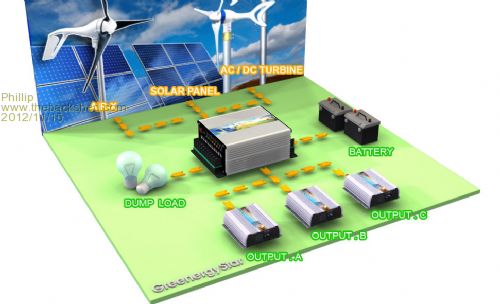

Posted: 06:32am 15 Nov 2012
Here is the Wind setup I am Looking at
The three outputs a,b,c have plugs for pluging in things ie lamps radio. Not complete house circuts. What are my options/inverter choices for removing complete 15 amp circuts 14/2 wire from my house pannel and hard wiring in to the inverter.
Maybe I am not looking at this right...once again new to this....

Posted: 02:18pm 15 Nov 2012
I think Yahoo2 summed the Apollo up very well and i agree with him, they are not much more than a weather cock, and a noisy one at that.
With such small blades they need to spin a very high RPM to make good power, and 90% of the time this wont happen.
The way they are designed you cant even modifie them to improve the design either.
If you could find someone with one, they would most likely give it to you to get rid of it.
