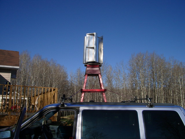

Here is a pic of mine and has a stall problem at startup, once it gets spinning its okay. Might have to change the dia bigger or smaller. don't know yet. There is a generator at bottom anf didn't really get nothing out until 15mph, not good. Thats why wanted to try F&P. I looked like a mad man going down the highway, bikers almost went into the ditch. Look a wind powered Van.
Wayne

Neat looking vawt....just what I'm trying to do. Small and portable. It looks to be around 70cm(28") tall with a dia. of 30cm(14").
This is an uneducated guess, but based on what I've seen, your right. I think you need to get more torque capability in there, and as you said, a larger dia. will do it.
After I decogged the F&P, there was a noticable difference in the effort required to turn it. The Eco Innovation claim a reduction from 900-950 to 450-500 after decogging.

Yes you are close this one is 2 feet height and 18" in dia. To decog it did you just file down each finger. I have a smaller version and this one seems to always spin in little wind. But its not loaded yet. Just thinking of putting a little one in it to power up some leds for fun. I used 3/4 shaft and 2 bearings to watch Glenn said. works good that part anyhow.
Wayne
