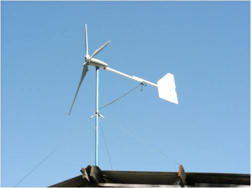

A picture of my old mill that Vic mentions the bungee allows 2 turns in each direction until it winds up and springs back to a neutral point.
The bungee has been on there for 3 years now and still ok, it's marine rigging bungee so it is UV protected.

  VK4AYQ said   Hi Grandpa
All the best
Excellent idea Bob.
So, I will scrap my idea to use a motor to reset it the mill, (Mechanical, usually is Fool proof), Plus you can also see it working.
