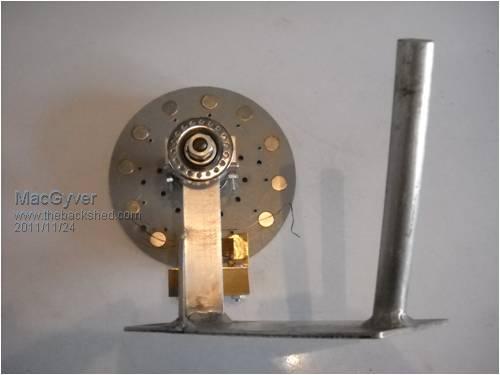

This is a top view of the Quick & Dirty. The working platform is from
another build and is welded aluminum. All the rest of the parts are
OFF THE SHELF and that was the momentum behind building this. I
was after something anyone could build with only basic hand tools.
In case anyone is wondering what all the empty holes are for in this
next picture, they were to hold the soft iron bars shown in this shot.
Originally, I attempted to build an axial-flux machine by reconstructing
each magnet pair into its own little "U" shaped magnet, with a flux-
return pathway through the iron. The idea was to then spin the mags
with a stationary coil between the two and create an alternator. It's
just too small; I tried it and it worked, but I got only a very tiny bit of
electricity for all the effort, so I trashed the idea. Now you know.

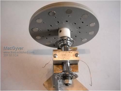

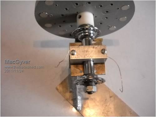

Pictured here is a front bicycle hub trapped in a slot and mounted atop
my platform using screws and nuts. The wheel is made of two pieces
of HDPE plastic. Holes for 1/2" neodymium magnets were drilled with
a "forstner" bit. There are two magnets in each hole, doubling their
strength. The pick-up coil is merely an old transformer with its coil
rewired using heavier-gauge wire than came with it. This particular
transformer was actually out of a fish-tank air pump, but any regular
step-up or-down transformer could be used by hack sawing off one or
more parts to form a "U" shape on which a coil or coils are wound.
Here's another view of the same thing. The plastic circles can be cut
using a hand saw and mounted to the hub shaft with flat washers. I
chose to use a bushing and set screw on this one because I had it just

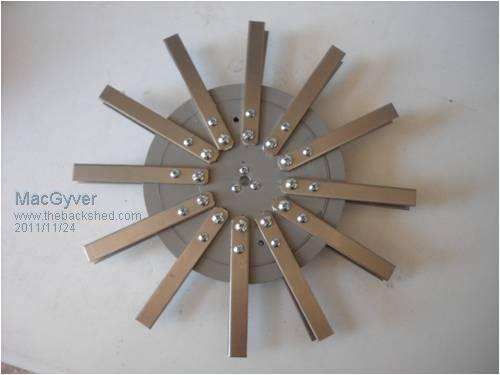

sitting around. The windmill blade would mount outboard of the face
of these two wheels using washers and nuts.

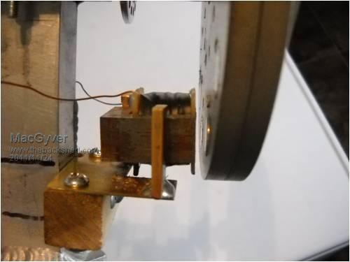

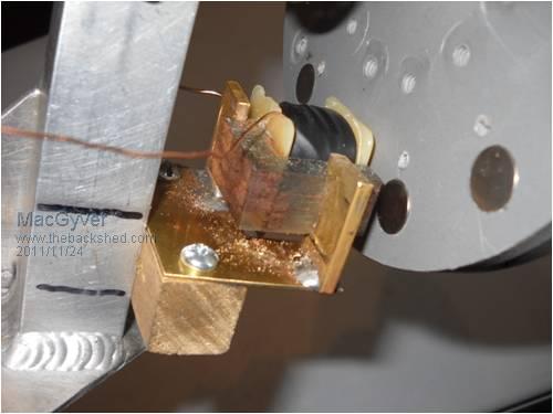

Here we see the little pick-up coil. It works just like a magneto in a
gas lawn mower. Each time a N-S or S-N pair of magnets passes the
ends of the "U" shaped soft metal piece, magnetic flux flows through
completing the magnetic circuit. In so doing, an electric current is
induced into the windings about one or more legs of the "U". Here I
have used only one coil and #14 enameled copper wire. I made the
coil holder from brass and soldered the brass to itself using high-
temp extremely strong solder.

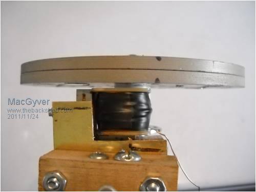

This shows the "air gap" separating the pick up from the magnet array.
It appears to be rather wide for a reason. This is so small, any closer
acts effectively as a parking brake! It generates a current of about 0.1
amps at 10 volts with the shaft spinning about 300 rpm. I know that's
not much, but more pick up stations could be added to a plate mounted
to the bicycle hub's body where the spokes would go, but I've lost interest
in continuing on. It works (barely) and that's enough for me.
This is a bottom view of the pick-up and air gap. The black stuff is
electrical tape around the coil windings. I used the original coil former
from the pump to wind my new coil. There are 12 magnet pair (24 mags)
and since the pick-up sees alternating N-S-N faces, six pick-up stations
could be used to increase the curent or voltage or both. Does it cog?
Does Pinochio have a wooden . . . well, you know.

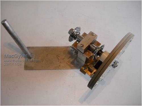

Since this is the end of my presentation, I thought it only fitting to title
this shot The End. This is a view from the tail post down through the
entire contraption (less blades, tail & tower of course).
