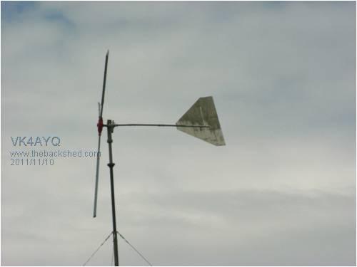

Hi Neil
Furling is a a black art and it involves a lot of cut and try.
Starting point, generator offset on pivot 3 to 5 percent
Tail pivot hing 5 degrees lay back and 8 degrees side angle.
A lot depends on the type of blade you use.
All the best
