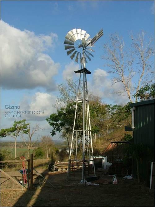

I have an old Z series Southern Cross windmill, just a baby 6 footer on a 25 foot tower. Its about 60 to 80 years old by the model I think. Looks like I will need to put it back into service in a few weeks, pumping water from a bore, so I thought I would give it a bit of a check over.
This is it when I had it up in the air in Mackay.

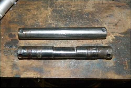

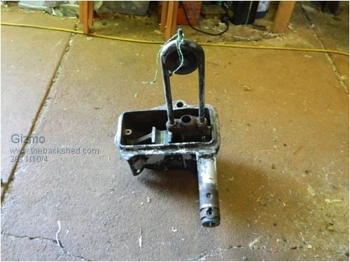

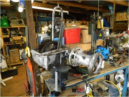

Its now in pieces, transported to my new home town Toowoomba. First I checked the main shaft for play, and it had lots, about 1mm in the bearings. So after spending a few hours knocking/drilling out pins and using my big hammer a lot, I managed to get the shaft out. It was about 22mm ( dont ask me for the imperial size ), very worn out in places, and rusty in others, so I bought a length of 24mm mild steel rod to replace it with. The bearings in this windmill are white metal, poured in place, and not easily replaced, so I figured it would be easier to ream them out to suit a larger shaft.
First I used a water blaster to remove decades of sludge and grime from the casing.

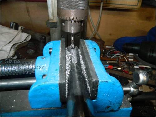

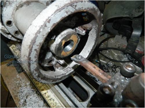

Reaming the front bearing was easy enough.

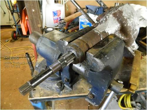

I then shaped the new 24mm shafts end into a basic cutting tool and reamed out the back bearings. The white metal is like lead, easy to cut.

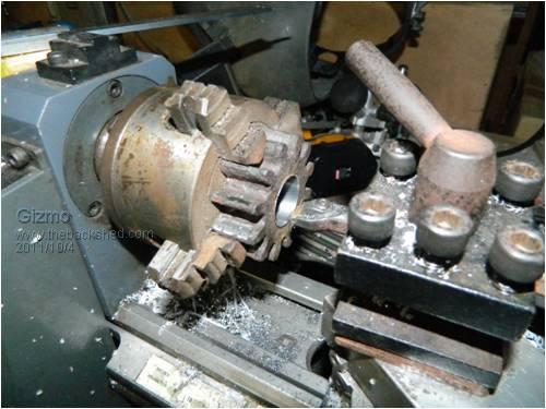

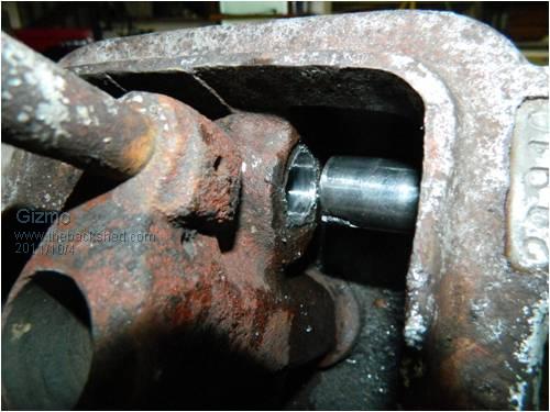

Next I machined the two small sprockets and wheel hub out to suit the new shaft.

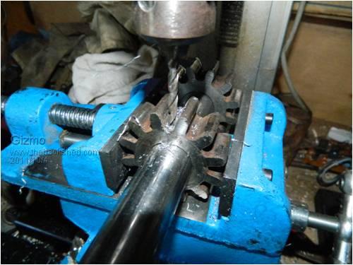

And machined a keyway into the new shaft and drilled the sprocket pin holes.
I also replaced the steel pin on th ecrank that does all the heavy lifting, it was a bit worn!

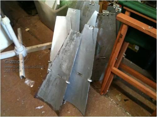

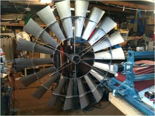

Next I fixed the fan ( turbine ). The blades were bent and out of shape, so I gave each one a basic panel beating.
The finished fan, just before I painted it. I need a bigger workshop!

They dont recommend it, but we used a gin pole to raise the whole assembled windmill at my place in Mackay. Its very heavy, I was using the car as a anchor and at one point it was dragging the car across the yard, wheels slipping on the grass. Once up it's just a matter of climbing up the tower to fill it with oil. I used engine oil, probably a bit thing, will use gear oil next time.
