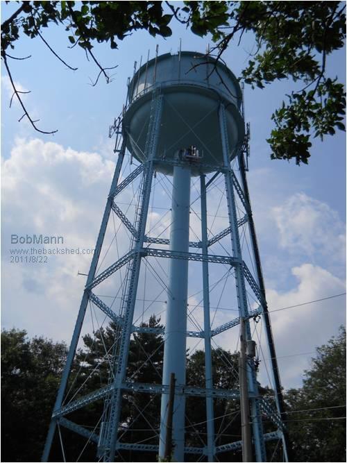

We got the Tree top Wind Mill with the Mann Smart Drive up on the Water Tower today at the 110 feet marker. Every one from this site and others have been a great help thank you all. The town of Pembroke has been behind me all the way.
Here is the turbine up and running.

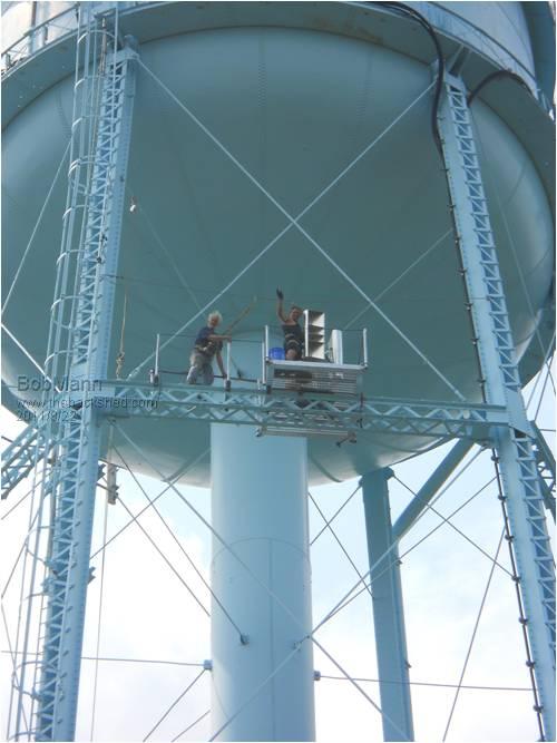

Here we are on the new platform and ready to let her run.
Jim and Cris gave me a hand today. We are running the data logger and grid ties to see what we can make from this site. I see 10 to 20+ MPH at that spot all the time.

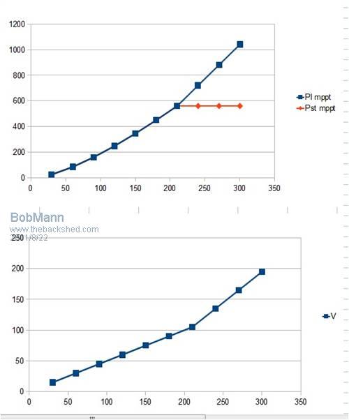

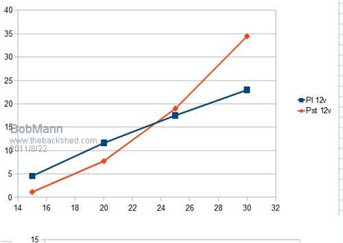

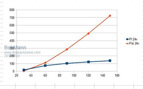

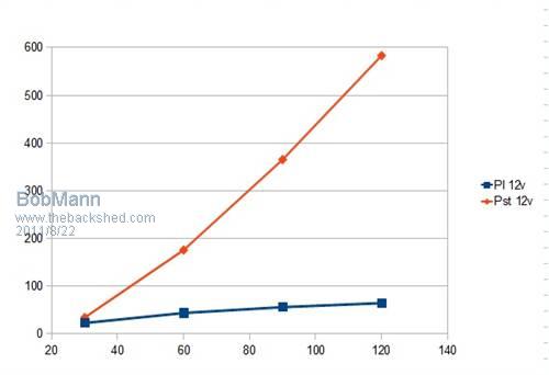

Here are some of the power charts for my Mann Made Turbine.
Steve from US-VAWT.com did the power output numbers for me.
