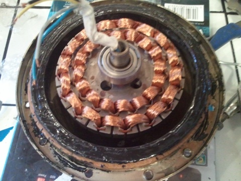

Hi back for more help please.
Ceiling fan new project best way of mounting.
Bridge rectifier best up top or down at the bottom.
How do you put them in parallel or series need amps not volts 1.5 amp per coil
And anything else you think would be help.
Best charge controller for it
Thanks alan

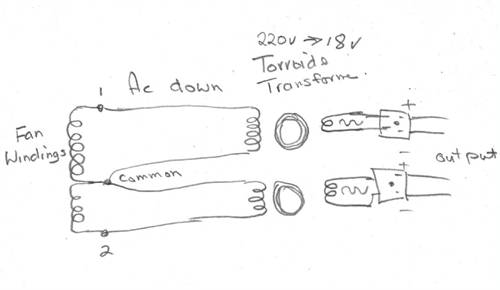

Just a suggestion.
Use two toroidal transformers to get the volts down to a usable level, Spin up the motor to a reasonable revolution you would expect to get from your blades, and measure the output volts on each winding set, you can then purchase two transformers to reflect the ratio needed to equalize the voltage at the output then use separate bridge rectifiers. Note: open circuit voltage indicated will be more than loaded voltage, if you can put a old 220 volt small transformer on when voltage testing it will give you a more accurate reading.
Be careful as the voltage produced could be lethal. 100 watt transformers would be more than enough for the output of the fan motor.
See if you can fit another neo on your stacks to increase efficiency by reducing air gap.
Don't expect miracles from these fan motors but doing this you may get close to 100 watts total.
Feed into a capacitor choke capacitor network for smoothing and then into a 5 amp solar regulator.
All the best
