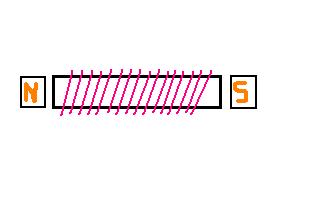

what about this in an axial ....say a flat coil was made up with a hole equal in size to the magnet...
when two n/s magnets aligned (moved) opposite the hole sides youd have a field generated across and through the coil ....now these would leave and another pair of s/n magnets would enter the coil and reverse the field ?
kind of like this but without the core and a squashed coil
thanks for your help...

You have to remember to not allow a north face and a south face to pass the same wire in the same plane of rotation or each will generate the same current, but in opposite directions creating a net "zero" charge on the wire.
As soon as I get my shop back (27 days!) I will be building an interesting contraption, which will be a three-phase alternator with only one magnet wheel and coils laced about both sides so as to produce current in the same direction even though one side of the same wire sees a N and the same wire but on the opposite side see a S. I'll make some drawings and toss them up when the time comes, so everyone can understand the basic principles.
In the mean time, it may do you well to review the electricity section of a high school or college physics text. Either will explain the left-hand and right-hand rule among other things, which help a lot when you are designing things.
