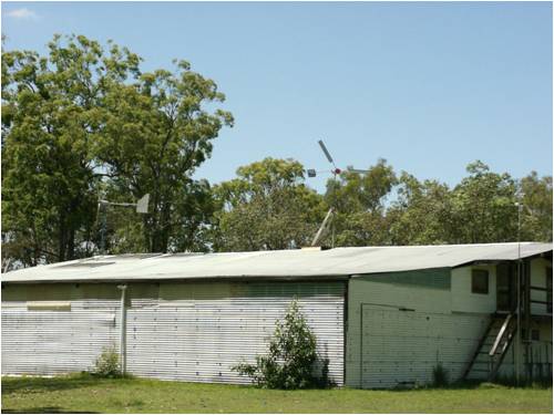

The two mills of mine are 14 meters apart and work OK except when the wind is in direct line with both mills, then the second one slows slightly above 10 ms it dosnt seem to make any difference.
As you can see from the photo the trees to the east of the mill are a more serious issue than the spacing as wind can be very turbulent from that direction. Need a hedge trimmer or a big storm while the ground is soft.

14mts is still a little to far apart for what I hoped. Was it a still day when the pic's were taken? I'm asking because the 2 mills seem to be facing different directions. The way the weather is at present you may get your wish with the trees in the east!

I live in hope, but in fear of Murphy. No wind that day, not much most times until I get a southeasterly.
