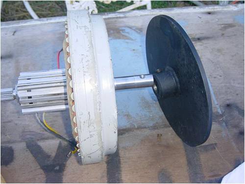

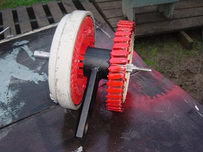

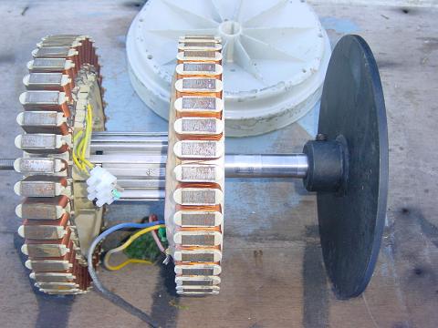

Hi hope this might help I drilled out the plastic magnet hub and put a keyway in.
then just cut off one spline for the blade mount.
and my hub.
Edited by shawn 2010-12-15
