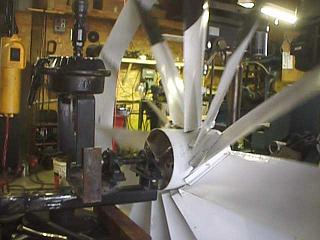

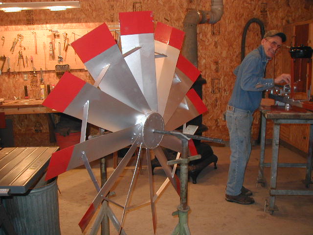

Nice, How many blades is that?

it has got 12 blades  that are 24 inches long pluse the hub in the center is 8 inches
have sold 4 in town here    most of them are for pond air

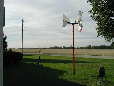

we  mounted a  truck pankaed to pump air  to the pool
made a small crankshaft  to run the rod up to the pump put check valves in line got plenty air pressure about 40 lbs
our lake is about 20 feet deep  keeps the lake frome freezeing

Thats a fine looking machine. Lots of blades makes lots of torque. And 40psi is proof that it works.
