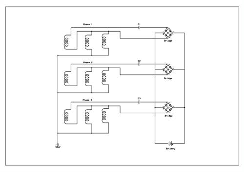

Posted: 01:48pm 04 Dec 2010
Hi Pete,
I have been thinking about this dual stage cutin approach, following our telephone conversation and the only way that I can see it working is not with multi tapped coils, but with 2 sets of isolated windings in each coil. You could only use a tapped winding, if all the coils in each phase were in parallel, and not in series. [I think the potential for circulating currents with parallel coils would be high, as in a delta config on an AxFx].
I see essentially a normal star connected 3 phase, 3 series coil per phase stator, with a second set of 3 seriesed windings added to each of the phase ends. This would result in a tapped winding.
It would then be possible for a main low turn count phase and a higher turn count phase to be on each phase.
This combo would work in conjunction with a series capacitor/rectifier output arrangement on the higher total turn count output. The lower turn count output would be the normal high current output to the main rectifiers.
There would not need to be a capacitor voltage doubler in this case, as the additional voltage would come from additional turns.
This would suit a windmill that was wound for the winds normally expected. There would be a slight improvement in low windspeed efficiency, as there would be only 1 set of rectifiers working to direct the current, but the copper required for the additional winding would take up space that could be used for the main winding, that would reduce the resistance that could improve performance of an alternator that was wound specifically for high windspeed power.
There is another way of winding this alternator. There could be potentially a slight harmonic power imbalance but, this would involve winding say, 2/3 of the coils the same with an optimum wire size to get the max turns with the lowest resistance. One of the coil positions in each phase could be a specially wound coil, consisting of a remnant of the thicker wire to give a tapping for the bottom end, that could change the high power winding turns a small percentage. The rest of the coil space would be of a thinner size wire, that could have multiple tapping points. This would be added the the free phase ends to make up a higher adjustable output voltage.
I can see a very adaptable prototype alternator to be made, rather than making a swag of stators.
I think you were on to something with this thread.
The only down fall I see with this is that any rewiring would need to be on the stator, and will require rectifiers and caps on the mill head.
There is potential here for a windmill that would have a variable impedance that would have an output that closely matched the wind energy. This would be a slightly harder coil build, and would be a similar load matching as a cap doubler, but would require mill head rectifiers and a DC transmission line.
I have tested most of the aspects, and this method is a lot easier than any electronic boost arrangement.
Gordon.
Posted: 03:09am 05 Dec 2010
What we are thinking of testing, is this configuration of coil windings as Gordon has explained above.
There is advantages and disadvantages to this configuration but nothing ventured nothing gained.
It will require for more windings per coil to get the higher cutin right but with parallel coils it will increase the current and with a series coil it will increase the voltage, giving a trade off with the best of both worlds.
Well thats the theory anyway. (yet to be proven)
Pete.

36 coils is a good starting point. I assume you have 48 magnets, making it a 3 phase machine of the usualy layout, thought there are other combinations of coils and magnets that can also make 3 phase power. 36 coils means 12 coils per phase, and thats a good starting point for a staggered stator. 12 divides down nicely, a string of 12, 2 of 6, 3 of 4, etc. You could dial up a wide range of output voltages. Would it be possible, if a bit messy, to bring all coil wires out of the stator?
jamesshaw89
Joined: 22/06/2011
Posts: 3
Posted: 11:21am 28 Jun 2011
Hi Glenn,
I was using the wrong words, 3 phase yes...I'm using 48 magnets and 36 coils with 72 wires coming out. I was going to put them all on a wiring block so I could rewire them with jumper wires...I'm going to gather some data this weekend with different test coils to see what different gauge wire will output and how many turns.
In my head I'm thinking of the output coils however they are wired are like batteries where I can put them in series or parallel to get the volts or amps I'm looking for...
If I need more volts/amps I will be able to add another set of magnets or maybe magnets on only certain output coils? Creating another stage or larger stage?
Maybe a combo of progressively thicker wired output coils, some/all with magnets on both side and still be able to add capacitors to step a low voltage up maybe? ...if I understand it right I can run the mill into say a 24 volt battery bank to clamp the voltage and wire the GTI into the bank to keep it's input voltage happy...
I'm thinking I'll be limited by the thinner wire coils hitting their max amps before the thicker wired coils will...unless I can drop/disconnect the thinner wired coils out at some point?
Thanks, Jim
