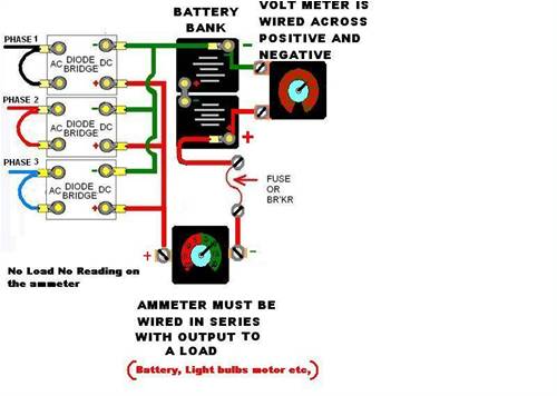

-A couple of thoughts come to mind, #1 are you certain your diodes are not damaged?
they could be shorted internally rather than open.
As Gordon has noted, if there is no load the ammeter will show nothing.
#2 Is the ammeter connected in series with your Load?
Here is a modified old post of mine showing my thoughts on a proper hookup.

The gen was wired up as per your diagram. I am now going to dismantle the wiring to make up a test rig to try and sort this problem out.
