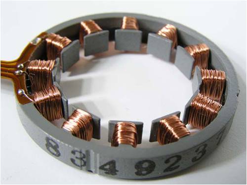

How cool is this?
This is a stator out of a computer hard drive. Looks almost exactly like the F&P
guts without any cogging iron cores (although they may actually be there, merely
hiding under plastic). Still, it's pretty cool that you could save weeks of shop time
short-cut by a little creative dumpster diving!
Just a thought. Of course, you know what they say about "idle minds"!
Edit: I just figured out that if 4 coils were wired in series and the magnets spinning inside the core were arranged properly, it would make this puppy a 3-phase alternator, right? (Thanks to Oz for that cool link!)
. . . . . MacEdited by MacGyver 2010-06-22

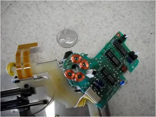

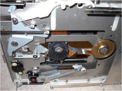

Apparently, all roads do not lead to the Emerald City. Case in point:
I scored a throw-away-ready hard drive from a neighbor. I took it
all apart to find that cool motor pictured in the first post.
Ain't takin' stuff apart a gas?
Here's the part I thought I was looking for. That's a quarter next to
it (American 25-cent coin) to give you an idea of its size.
As most are already aware, I'm into "small" but this is even beyond me. There's a country-western song sung over here and the guy singing says something like "It's okay to be itty-bitty . . . etc." so I just figured that if small is cool enough for the s*!t kickers, it's okay for me too. Well, small is cool, but this is way too small, even for me!

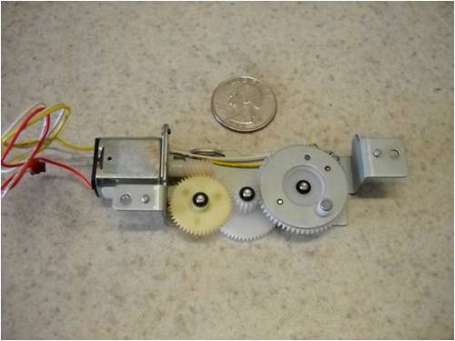

Don't quite know what to make of this. It's an itty-bitty electric motor
with a worm and down-gears. Too cool to toss. It's headed for my
"Damfino" drawer. Damfiknow what's in there!

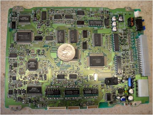

Remember that Barbara Striesand song, "Memories"? Here's some for
ya. This is the hard drive memory, I think. That's the same quarter
sitting there, by the way; everything here is rrrrrreally small!

So if you would have had a "Quarter" in the 1st photo with the stator, how big would the "Quarter" be? (How's that for improper grammer?)

Hmmm . . . . You know, that's a really good question. I got the picture off the Internet and just "assumed" it would be about as wide as a computer tower, like 3" or 3 1/2" or so.
Heck, I hope they're not all that small. What a disappointment that would be, eh?

They are the same as what some of us have used for ages in anemometers and phone charges, rotory encoders, etc.
You will find they are already a 3 phase motor and no rewire of the windings needed except for the same reasons as we do with a F&P.
You will find these sort of motors in many things from HDD, to pc fans, video heads..........and the list goes on.
A lot of times you will find there is 4 wires because they bring the star connection out and tie it to +v and then phase the 3 sets of coils in sequence with V- to give rotation.
If you want to use it as a generator than forget the star connection and rectifie the other 3 wires and ...presto.. instant generator.
Im just not sure what you will do with all the power you make.
Maybe dazzle yourself with a led.
They are cute all the same.

Where this all started was in my mind. Yeah, I know -- flag on the play! Anyway, Glen had a post in his diary about a motor that looks the same as the picture I posted and he said it was out of a hard drive, but the thing was like 12" diameter and even had a rubber wheel mounted on its perimeter. He was going to use it to drive a solar-powered car or something, I think.
So, I put 2 and 2 together (and apparently came up with 5!) and figured a hard-drive motor would be similar in size to the width of a computer tower and used that information to springboard myself into misunderstanding everything.

I have a similar stator in my hand at the moment. It measures 1.5 inches - outside diameter. It came out of an old cd burner. Hope that helps!

Thanks, mate. I threw the post up hoping to find one the size of Gizmo's. His looks to be about a foot across the middle, perhaps the size of an F&P (?) dishwashing machine motor.
As Pete pointed out, I'm all into small, but this is TOO small.
