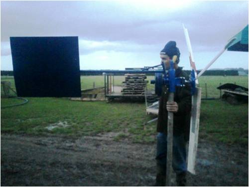

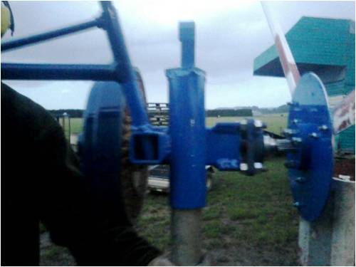

This is my second F&p windmill. I havent got it up the tower yet (still waiting on some pipe to make it) but it is looking good so far. It is the standard 7X2c rewire.
I followed the plans described on this site. The only thing i did different was mounting the blades. I got a disc laser cut with the spline so i don't have to weld the blades to the shaft and the whole assembly is able to be removed with one nut. the blades are made from the markers of the side of the road (didn't have any large pipe and they where handy so i used them). They work surprisingly well and they are very strong having been flung across the paddock when the disc they where attached to shattered (it was only 10mm ply) and then surviving the whole top of my previous mill coming off and landing on the ground.

I can just see it now!
The one eyed council cows going missing from the road sides for a larger cause.
I credit you on your blade idea. ( not sure if the council will )
I like the way you say they were handy, (as though they were planted for your cause)
At least you can have red eyes one side and white the other.
Nice build and a good use of resources.
