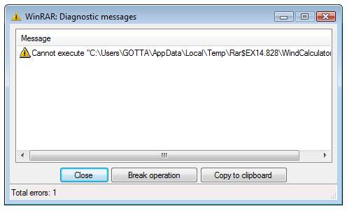

Its Broken!!
I get this when i try to view it.
Pete.

Hmmm Might be cause of winRar, but when I download from the link it works fine but I use
7Zip. I'll recompress it with WinRar and see if that fixes it. Here's the .Rar file from WinRar.2010-04-04_160704_WindCalculatorRAR.rar

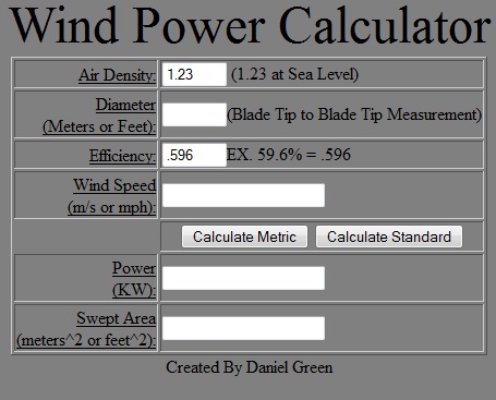

Here's a Screenshot of the Browser Calculator.

I downloaded your Calculator-(Not the open office one.)
with Firefox. on XP, No problem. works great for a ballpark estimate. a great tool for anyone shopping to buy a mill, this can quickly tell what is needed to satisfy requirements in terms of size for output. Thanks for a good freeby. The Altons Calc is a designers tool and would be the one to use if carving an efficient blade set for a specific Loading at RPM

  Greenbelt said   GreemD88,
That's what I was thinking, When People see a wind turbines performance they can type in the diameter and rated wind speed and see if someones lying or not ;)
Here's the basic Formula P=0.5*rho*A*V^3
P = Watts
rho = Air Density (kg/m3)
A = Swept Area Meters Squared - pi*r^2
V^3 = Velocity Cubed. m/sEdited by GreenD88 2010-04-06

Hmmm still get the same message ...error?
Im running Vista IE7 (Well I think it is 7.)
Anyone got a link to a free Winzip download, as WinRar drives me mad many a time.
