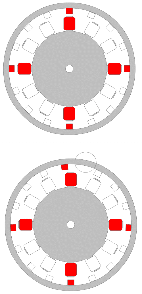

Now to the theory. This is hard to explain, but hopefully with the pictures you can see what I'm getting at. The first picture below (sorry they are so big, but I needed the detail) shows a 12 pole 16 magnet 3 phase alternator, typical design. Stator in the middle, magnet rotate around the out side, magnets at 22.5 degrees apart. I've coloured one phase red. You can see there are 4 magnets lined up exactly with 4 stator poles. This would make the alternator hard to get started ( cogging as we call it ). Now look at the 2nd drawing. The magnets are slightly offset. There are still 16 magnets, but they dont quite make it around and are spaced at about 21.5 degrees apart, leaving a gap ( circled ). This gap is only a few degrees wide. This means there will never be more than 1 magnet aligned with a pole, the other magnets for that phase are close, but not exactly lined up, they are spread out a little. And the magnets for the other phases are also spread out a little. See where this is going? There is no peak in magnet flus as the magnets pass the stator poles, more of a gentle hump. With the correct magnet spacing, the gentle humps for each phase will join to give a near smooth rotation, no cogging as we know it.
There would be a small loss in output voltage, as the flux peak on all poles at once is missing, but there would also be a increase in current. The sine wave would have a flatter peak, but wider mid rage where the real power is, around the RMS level.
I see a lot of induction motor conversions with evenly spaced magnets, but I believe a uneven spacing would reduce cogging, instead of skewed magnets or laminations.

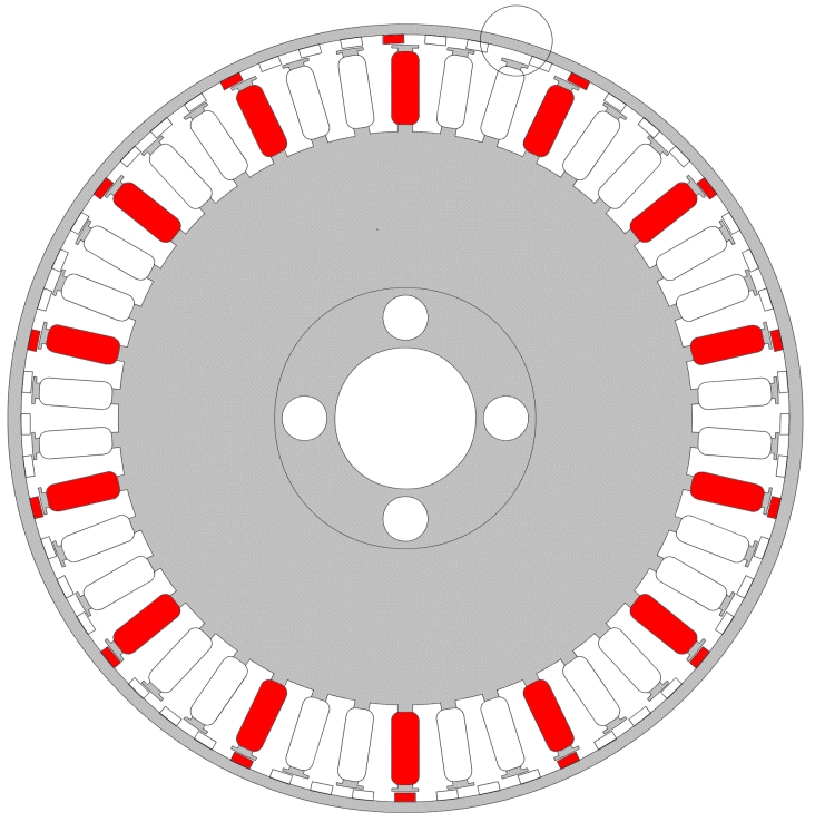

Now for the grand finally. F&P. For the Neo conversion guys. I drew up this drawing...
Each magnet is installed slightly under the 6.428 degrees spacing they are from factory, closer to 6.39 degrees will give a "gap", shown circled. You can see how only one magnet and stator pole is exactly aligned for the highlighted phase, reducing the cogging effort by 14 times!. There would be a slight reduction in peak sinewave voltage, but a slight increase in current, and with so many poles, virtually no cogging, even with neo magnets.

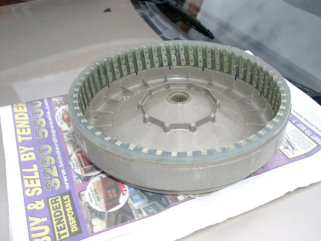

I'd like to glue some Neo's in a F&P rotor that I have stripped for this purpose- bye the way the magnets come out fairly clean and easy ,after the first one.
Enclosing a pic of a F&P rotor that Matt from melbourne did when he visited my place. If Glenns idea works ,I'll recover these Neo's and try for a dual set. hahaha,just joking.

The angle I've come up with is 6.3920 degrees between magnets. This leaves a "gap" of 8.44 degrees. The default angle from factory is 6.4285 degrees.
It took a lot of coffee to work this out, and I'm not 100% sure its correct.
The idea is to spread the magnets over the poles of one phase, without crossing over to the next phase. So for the 14 poles of each phase, each magnet is slightly offset. So as the hub rotates, each of the 14 magents pass the same phase pole in sequence instead of at one time. But you need to make sure the magnets for the next phase dont start their sequence until this phase is done. I've attached a zipped up DXF file, for anyone with a CAD program.
This is still theory, but I think it works.

Hello Highlander and Glenn., I've got the new rotor up (factory-non cogging), and it spins up much quicker than any of our home-made neo types or the old Ceramic rotors from the factory. Good. But I've a feeling we're not going to get anywhere near the power from the new rotor that is apparently available from my Neo conversion. (On the weekend the new rotor was really powering along and all I could see from it was 225 watts. Whereas if I remember right ,the neo conversion gave out close to 800 watts or more a few times in a big blow.

Tried to remove those little strip magnets that F&P put in their original rotor(very scarce to get now)-no luck-- Every one breaks into lots of pieces, they might be Neo's , but they are very thin and have no strength when prising them out.
We had a storm last night ,so dressing gown on ,I went to the control panel to see the peak watts-350 watts- ,this is with the new F&P rotor and re-configured 7/2 .8mm stator. Soooo, not so good ,compared to the cogging Neo conversion rotor and 3 /2 stator, which gave out in a similar storm nearly 800 watts.

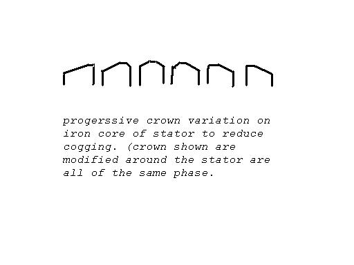

Gismo, how about instead of offsetting the magnets, within
the range of perceding and following magnets, that we grind
progressive lead in and lead out bevils off the iron core. A
refined version of our old decogging practice of rounding off
the tops of the cores?
Further to this I would randomly position these modified
crowns of each phase around stator to elimimate drummimg
vibration and not as the explanitory sketch indicates.
