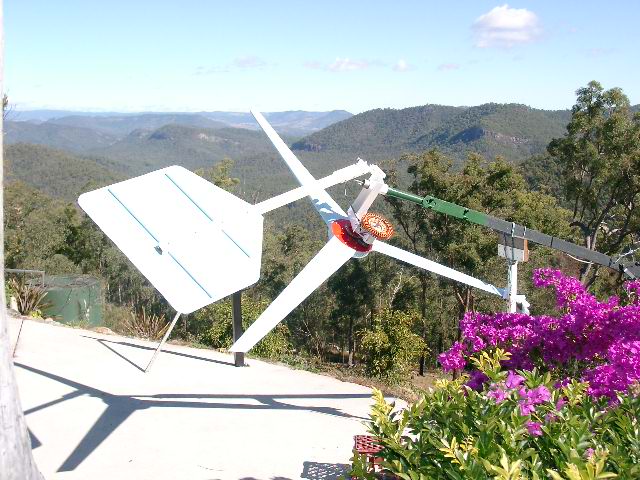

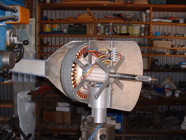

The F&P windmills are popping up everywhere. I recently contacted Trevor Richards of Kuttabul, just north of my home town Mackay. Trev has been building windmills for some time now and also plays around with the F&P motor.
Trev tells me he wasn't aware others were also using the F&P on windmills, makes me wonder just how many F&P windmills there are out there.
This photo shows the inside of one of his F&P windmills.
A dual stator version.
Trev owns a fibreglass and foundary business, and also deals in solar/wind systems. Notice his cast aluminium windmill parts.
I'll post more information soon.

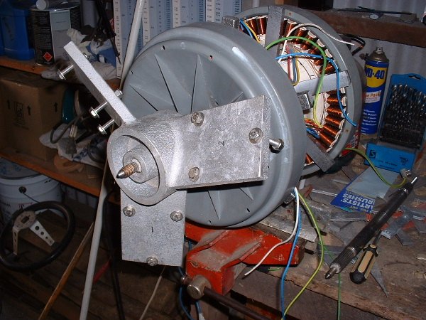

I had a talk to Trev tonight. I said there would be interrest in his blade hubs, and we also discussed the possibility of a replacement aluminium magnet hub. The hub would be a straight swap for the plastic unit, just add a steel backing band and neo magnets.
This is Trev's business card, drop him a email....

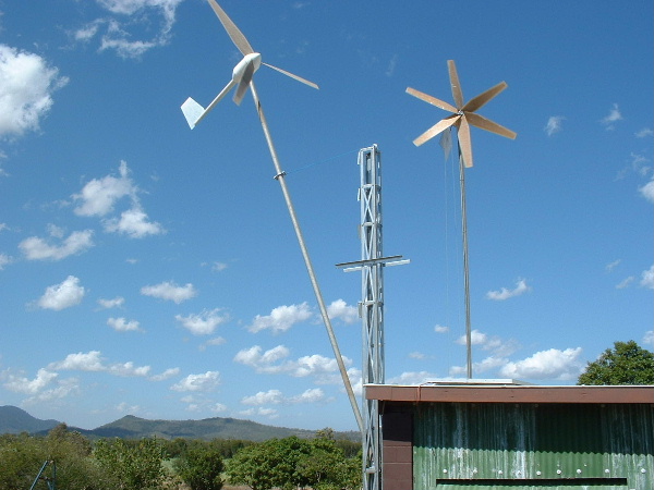

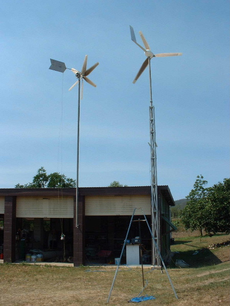

Hey Trev.
I like that tower. I need to build a new tower for a Lenz style windmill, 2400 high by 2100 wide. As there will be a 1 inch drive shaft down the tower to the alternator at ground level, I thought a latice tower with guy wires would be the way to go. But I'm undecided on its design, or even the materials to make it from. I was thinking of 3 legs using 50mm Angle iron, but not sure of its load capabilities.

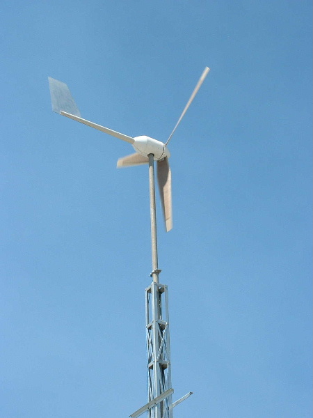

Posted: 10:08am 22 Jul 2006
Hi Glenn, Yes, this lattice tower is just another of my creations,in fact everything I have, I made. As can be seen with the other single gal pipe, you need to have something to fix it to. (I really detest guy wires). This lattice tower is free standing. It is made from 50x50x4 duragal angle. I paid $74/6.5m length, some time ago. The height of the lattice tower consequently is 6.5m high, but there is no reason why it couldn't be joined to go higher. The lattice uses 25x3 gal flat. Then I use the gal pipe, also 6.5m, the same as the other machine is on. The idea was for easier lifting & lowering, we can use the car. (The single pole is lifted & Lowered with a front end loader.) And then the idea is for lifting directly up to gain extra height, but I havn't tried to do this yet. I possibly will need to use the shed to give extra support if I lift it up. The square of the lattice tower is 200mm. I really should have made it bigger. The foundation is 1m in the ground and the frame is bolted with 20mm 316 s/s thread out of the concrete.

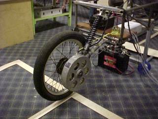

Yes those metal laminations behind the magnets are required. We played around with a aluminium hub on a F&P several years ago on a solar car. The car was built to race in the World Solar Challenge. We rewound the F&P stator with heavier wire, but eventually gave up on the motor, a lot of controller bugs to sort out and we were running out of time.
The web site still exists, though no longer public http://www.thebackshed.com/mackaysolarcar.
We found our new aluminium hub had only slightly more strength than a standard ceramic hub, and yep, we didnt have any metal laminations behind the magnets.
One way to embed steel into the aluminium hub could be to use loops of steel wire instead of flat steel. Or maybe lengths of steel strapping. The steel would need to be close to the surface of the aluminium, and therefore close to the back of the magnets.

Hi Bruce, Had another batch of aluminium casting recently & added the prop hub. It is made with marine grade, that is high corrosion resistance. Do you want it machined, what shaft size???? key (size)or spline???? Do you want to machine it yourself??? I will have a look at casting the motor magnet hub with the steel in it later.
