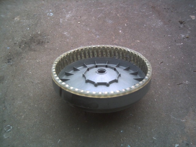

Hi All,
I have just got back from holidays up north, where i met up with Bruce. He brought some Neos of me for two rotors and we did the conversion, as Bruce was aware the placement of the magnets can be tricky. Once resined in place the rotor is very strong.
He informed me of his tests with the new Neo rotor and he was very impressed, as i thought he would be, 800 watts+.
I would say about three times the power or more. Cogging is a little more, but you need a larger blade diametre to drive the Neo rotor as it puts out much more power, this also helps to get it started as larger blades will give more starting power.
I recommend at least a 2.4M blade diametre.
Anyone interested in the Neo rotors can either buy the magnets from me for around $80 a set, or buy a completed changeover rotor for around $200, which i recomend as the conversion can be easy to stuff up, (you have to supply me with a good magnet rotor). I use 4 smaller magnets to make up 1 north or south magnet. A total of 224  Neo magnets are used. I reason I do this is that I can get the magnets cheap. Each magnet is 19mm/9mm/3mm.
Will post some photos soon.

Matt Lyons
Matt Lyons

Posted: 03:24am 18 Sep 2005
Matt Lyons
Chris
Joined: 12/09/2005
Posts: 146
Posted: 07:42am 18 Sep 2005
That looks great! Looks stock from factory
