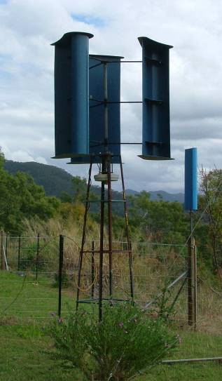

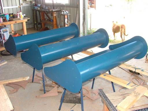

I made some winglets ( Is that how its spelt? ) to the Lenz2 on the weekend. Ed pointed out they can improve efficiency, so I drew up a desing in CAD and used the cnc router to cut out a set from 3mm ply wood.
Painted them blue to match the rest of the wings. Held on with pop rivets. While I was at it I added a meter to the tower, it was a little short at 1.5 meters high
Will see how it goes over the next couple of weeks. The winds are starting to pick up, finally!
