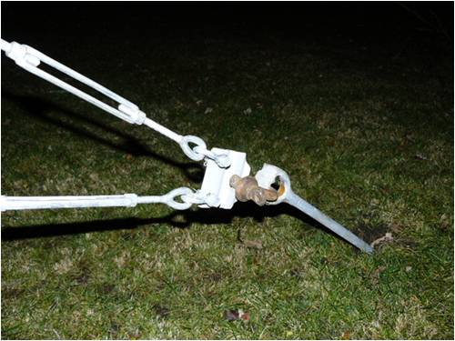

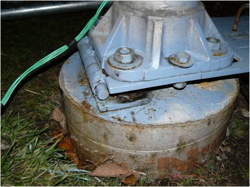

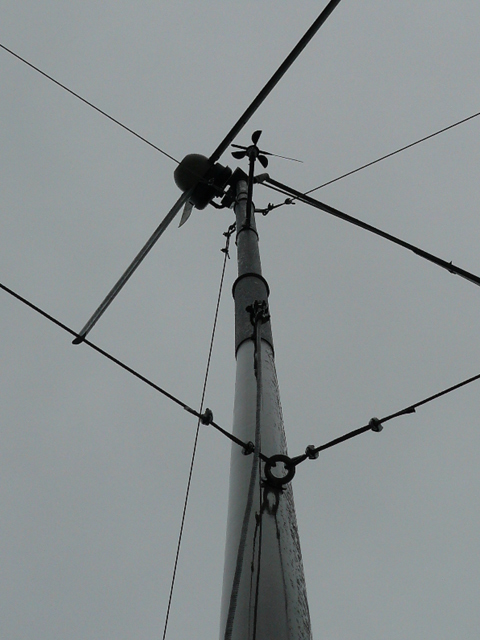

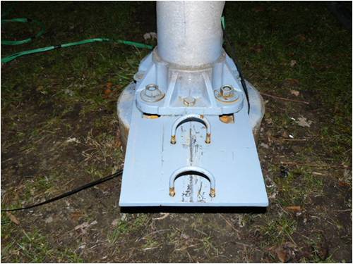

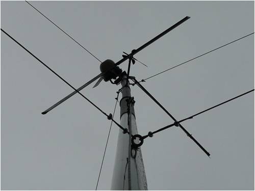

JimBo911
Joined: 26/03/2009
Posts: 262
Posted: 01:37am 18 Nov 2009
imsmooth
A few pictures of my present setup.
Screw in auger, tower hinge plate with gin pole u bolts.
Hey the neo,s are working great. 60 series F&P 700 watts.
Thanks again.
Posted: 04:03am 18 Nov 2009
Hi Jim,
the hinged base with detatchable gin pole should work well.
I hope you intend to fully wire all the D shackles and the turn buckles. Post a picture with them all wired, and I will post a positive comment. I have seem the results of a pin working loose on a D shackle, and a separate instance with a turnbuckle unwinding. Not pretty.
Mechanical devices need periodic checking and maintenance.
Gordon.
imsmooth
Joined: 07/02/2008
Posts: 214
Posted: 04:52am 18 Nov 2009
Jim,
I am glad to hear that your project is making power with the arc magnets. I don't think many know that this is an option for improved power from the F&P. See arc neo magnets
How tall is your tower and what size guy wires do you have? The pole looks pretty wide. How far is it from your house?Edited by imsmooth 2009-11-19

Posted: 02:36pm 18 Nov 2009
Gordon
It took me a long time to get that dam hinge plate to work. It pivots on an fixed ark with no other movement getting the bolts to line up wasn't easy. The mounting bolts farthest away from the hinge worked OK because the holes in the tower came down on them with less of an ark but the closer ones gave me a hard time. I got the idea of a hinge plate from the till up tower kit you can buy from South West Wind they sell it with there SkyStream 3.7 The reason I like the hinge plate is because the plate will only let the tower till in one direction. (North South etc) Thinking that this would make tilling a lot safer and easier.
All of the 5/16 shackles do have cotter pins in them, the one and only 5/8 shackle does not I WILL CHANGE THAT. Never thought of the turn buckles working lose, will take your advice and modify them accordingly.
imsmooth
Yeah I am glad that I went with your neo's 700 watts peak (so far) definitely surprised me. Together with one of Gordons caps/doubler it seems to be working well. It did involve more work but I am now reaping the rewards of your design. Other forum members have had difficulty stopping there F&P mills with dynamic braking. My mill has shut down each and very time and quickly I might add.
My tower believe it or not starts out with a 30' used, aluminum, tapered, flag pole. I got REAL lucky and sourced it from a friend for free. Just so happens that a 4" inch id pipe (4" galvanized imc electrical conduit) slips over the top the alum flag pole and goes down about 3 feet with the flag pole being tapered it fits nicely and is centered perfectly, I had to machine a spacing bushing (PVC) to take up the clearance between the pole and pipe at the top of the alm pole. The 4" imc conduit extends two feet above the flag pole, total length of the the 4" conduit is 5'. From there I used a 4" to 3" galvanized reducing coupling ($60.00 ouch) to a 10 foot length of 3" imc galvanized conduit. Then again from the 3" to 2" galvanized water pipe. The 2" pipe is 5' long and gives me more blade to tower clearance. Cable specs are 1/4 inch dia , 7*7 strand, 1220 lbs working load, 1880 lbs breaking. The mill sits up 47' with the blade tips another 4'6". I have a 50' height ordinance over here. Truth be told at 47' tilling it up and down has some scary moments not sure if I would care to till anything taller.
I built a small room addition on my house several years ago the tower is approximately 35' from the addition if it did come down in the direction of my addition it would hit. My neighbor applied for a height variance with the county to get a permit for his mill, the county insisted that the tower have a fall zone and be fenced in.
