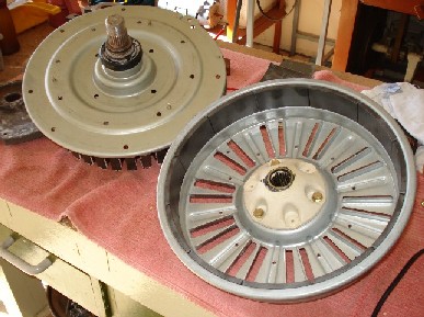

I bought an LG motor from smart drives ,thanks Cameron.
I pulled it apart yesterday and it seems to be very much stronger and larger than the F&P .
This is the top-end loaded washing machine ,,there are 2 types one is a front-loader (smaller than the F&P )
but this top-end loader washing machine motor is very rugged.
The wiring is between the .6mm and 1mm wire ,,I think.
the magnets are larger than the F&P and must be "slanted" within the magnetic material ,,as there is no cogging with this unit.
The fingers on the stator are larger than the F&P .
The bearings,the front bearing is larger ,fitting on to the 28mm shaft . The rear bearing looks like it's the same size as the F&P bearings.
The shaft is larger and shorter than the F&P.
Mounting would be very easy and strong as the body is pressed steel with lots of mounting holes.
The magnet rotor housing is a strong pressed steel with a strong plastic spline hub bolted to it.
I would like to get hold of another magnetic rotor so I could fit Neo's into it ..
I'd reckon this modified unit with Neo's would be a very good performer..
search this forum for "LG" to look at some pic's ..
BruceEdited by brucedownunder2 2009-12-01

Posted: 04:25am 05 Nov 2009
A pic of the larger size rotor and stator
Bruce
Bushboy
Posted: 04:29am 05 Nov 2009
Hey Bruce
Its a neat looking unit, hopefuly we will start to see more of these popping up.
I would try caps instead of Neo magents, caps a cheaper and a lot easier to use.
Do you still have that test jig Bruce?

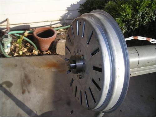

I knock out the center plastic and took a sproket and machine down hub to fit rotor hole and drill /tap for bolts to go into sproket
