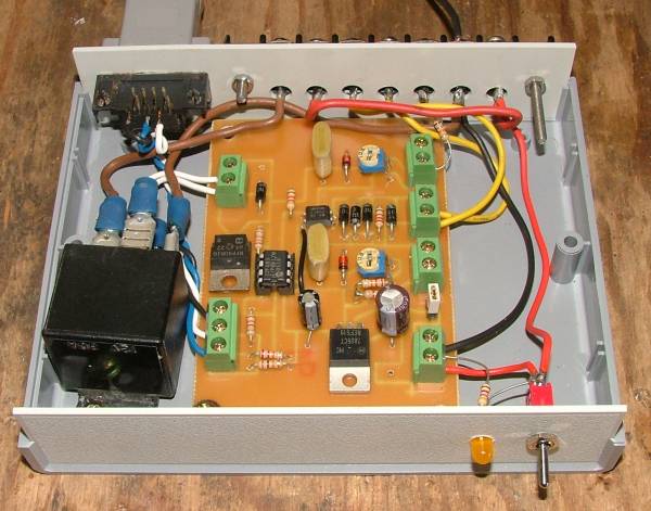

Teaser photo...
As you can see there isn't much to it, most of the work is done by the software in the PicAxe chip and the attached computer. A computer is only needed for logging, the controller will work fine without it, though you will need a PC for the initial setup. I use a relay to switch the load across the battery. I did consider MOSFETs, but relays are cheap and easy to use.
The controller sends logging information every second. I did consider increasing this period to reduce power consumption of the PicAxe, but total current draw is only 8mA, bugger all.
GlennEdited by Gizmo 2006-06-20
