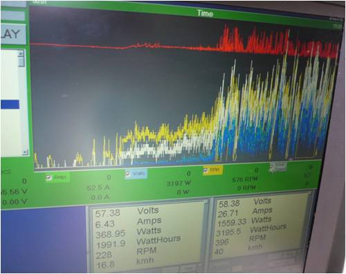

Well ,another day blowin a gale , I swapped the blades from the F&P onto the Ax the other day and put the old ABS blades on the F&P Dual . With the blade dia now down to 3.1m I figured it would not be able to get to the highs it had a couple of weeks back before the blade let go .
Wrong again with a blast of wind coming through at 57klm it punched through 3 Kw ( 3197w @ 576 Rpm ) shown below the recording on the piclog.
I have had it down quite a few times today to keep reseting the furling moment and have been keeping a eye on how hot it is running and after quite a long period of high output , I was still able to hold my hand on the housing for as long as I wanted , and no smells of heated resin coming from inside , which is a good sign
The furling now is starting in 25 to 30 klm and is fully furled at 40 , but even in the fully furled position it is punching out arround 2Kw .. But the best thing is when the wind dies down to nothing and the Cap/doubler/quaddrupler takes over and keeps the power flowing with out stalling the blades , No complicated star /delta switching or mppt tracker..

The 3.1kW from a 3.1m rotor is getting pretty extreme. How is the stator handling the abuse? There were worries that the enclosed design would cook and burn up. I have not been able to check mine for signs of heat yet. My coils are hollow, so there is a larger surface area for cooling. The windmill must still be above 90% efficient at 3kW, or else I would expect smoking coils. Probably need to see how fast the stator rises in temp with say a fixed current through the coils at say 10A.
I expect that the windage factor at the 400-500rpm would cool the system quite effectively.

hi mate . can you tell me what you are using for data capture ? is that a USB connected oscilloscope on your computer ?
and also , is there more detail somewhere on the AX FX construction you used ?
.. and the circuit you are using for the cap doubler ?
trying to find ways to improve bottom end start up in the low wind range and lift average power production here with AXFX.

The data logging is done by the Picloger that Glenn origionaly designed , this one I have is a dual piclog and was modified to suit 48v and tricked up a bit by Gordon as is the cap/doubler setup , both these are in the main page info somewhere .
There is further detail on how I built the Oz Ax Fx in a post called Homegrown Ax Fx . It was designed with lower resistance to use the cap/doubler to get the low wind power then at 200rpm its raw power with max efficiency and very little stator heating.
Yea , Perry these blades can really deliver the power , I have always said " no power in = no power out " . I stuffed arround for years wasting my time trying to build a good blade , I thought my ABS pipe blades were good untill I tried these . Would't waste my time doing all that again ..
