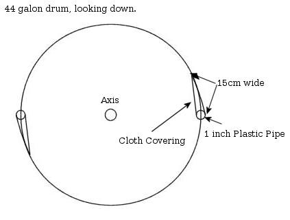

How's this for an idea?
Get a 44 gallon drum.
Use a bit of string to mark out two 15cm wide vanes, spiraling symmetrically from the top of the drum on one side to the bottom of the drum on the other.
Cut out the waste.
Cut a single slit lengthwise down the side of some inch polypipe and slip this over the leading edge of each vane.
Wrap cotton bandage tightly from the polypipe to the trailing edge of the steel vane. This will create a helical airfoil.
Saturate the cotton with fibreglass resin.
Find the centres of the drum top and bottom, whack on some bearings, do a bit of balancing, and Bob's your Auntie.
Watcha reckon then?
(The airfoil shape wouldn't be optimal but it might work. It would be better to glue some styrofoam to both sides of the vane and rasp it to shape, but this would take a bit longer. Another possibility would be to cut some styrofoam into 15cm wide strips, run them under a hot wire to get the shape and glue this onto the steel front and back.)

   what you said
   made no sense
Posted: 12:38am 05 Jun 2006
I worked it out...
Looking down from top, this shows how Allan gets the aerofoil shape. Not shown is the twist, but the windmill sort of looks like a barber pole from the side, sprial shape. The spiral means the windmill is making even power as it rotates, where a straight wing darrious has torque pulses as it rotates.
Its a good idea, would be simple to make.

Hey Makourain,
And I thought that description was a regular piece of literature! Glenn's drawing makes it clear.
I'm 2000 miles from my (very nice) workshop or I'd try it myself. I thought I'd make one today out of a plastic bucket and some hose to see if it works, but I've got distracted.
