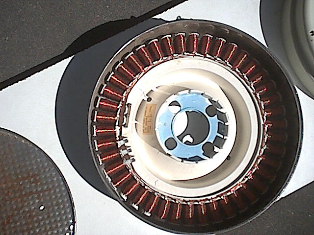

I'm planning something similar and also toying with the idea of using a metal rotor, the F&P stators are excellent but the standard rotors are average and inhibits potential, bellow is a pic of an old flimsy cake tin though I'm think I can get new thicker ones from department stores maybe these might work, anyone got other ideas?

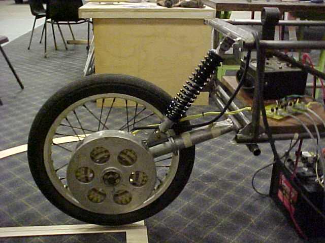

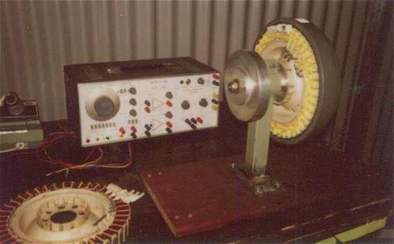

We played around with using the F&P as a motor to drive a solar car about 6 years ago. This is our test rig, with a standard hub.
The stator on test was rewound with 4mm wire ( yellow insulation ). To increase the output power we had a new hub cast from aluminium.

And on the car. The motor had great potential, but we gave up after a few months, had too many problems with the drive circuit, kept popping power mosfets. Ended up using a DC motor and drive chain.

Nice hub, did you lathe it out of billet aluminium?
Steel intensifies the flux to the coils and aluminium does not have the same properties, maybe the use of steel laminations inside the alloy rotor?

That hub was cast and machined. The second one we made had steel laminations embedded.
Keep looking into your cake tin hub. Especially at ways of making it stronger. I did look into using steel pipe, a lasercut end plate and 2 stacked stators to get some serious power. If I were to use 3mm thick magnets, and have a 1mm air gap, I would have needed a pipe with a internal diameter of 262mm. Well nothing was close, all I could find was 250id or 300id. The 250id pipe has a od of 273mm. It might be possible to machine it out to 262mm, leaving a 5.5mm wall thickness, nice and strong. Cost stopped me, but still its an idea.

It made about 1.5kW, a couple of HP. These solar cars are very light so 2 HP will drive it at over 100kmh.
We built our own controller. Back then we didn't really know enough about what we were doing.
