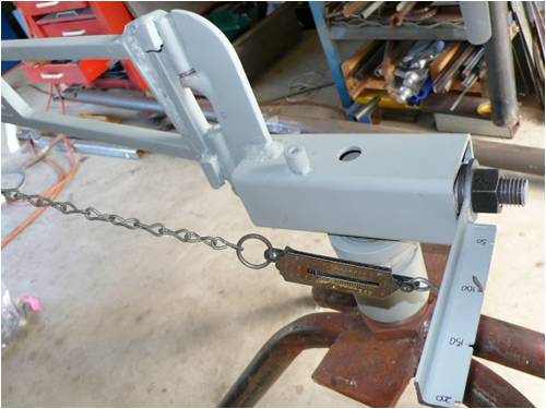

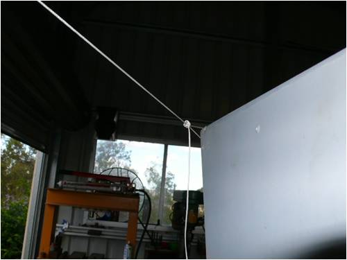

Because I already have built my tails and dont really understand all the sin, cos , tan , stuff I decided to use a spring scale and alter the angle of the tail pivot untill I reached the 4 - 5 Kg , and as I can change the blade offset from 0 to 200mm it would be the 1/2 way mark if I wanted to increase or decrease the furling moment . The pics below show how I set all this up using a piece of string to act as the resistance on the tail tip ( the wind) and the spring scale pulling at the point of the rotor centre .
I ended up with a piviot angle of 5deg to the side and 4deg back , so I put the dual back together and up and waited for the wind which I havn't had a lot of late.
A couple of puffs came along and then it started furling in 12klm - 3m/s and when the wind hit the tail from the piviot side the tail would furl and then bring the blades arround , I decreased the offset to 50mm which then increased the wind speed required to furl but the tail weight acting on the blades was to light .
So down it came and out with the grinder and welder and I changed the side and back angle to 10 & 8 deg which gave 12kg furl force @ 100mm offset , so its back up in the air again and hopefully right ,now but there has not been enough wind to test if it is starting to furl at 30klm or how smooth the furling action will be.

The reason I did the shallow angles is thats what gave 4.5Kg of force to counter balance the furl force moment from the equasion . I am trying to get softest furl I can . By having minimal offset and the lightest tail weight I can achieve with my tail design , my tail is down to 4.5 Kg and I am trying to keep the offset under 100mm because to keep these down I think will give a soft furl with minimal gyro forces on the blades/head/ tower, also I have been watching the effect larger offsets have on blade attack angle in light breeze and will start a new thread on that subject soon as it causes massive power loss in light to medium wind.

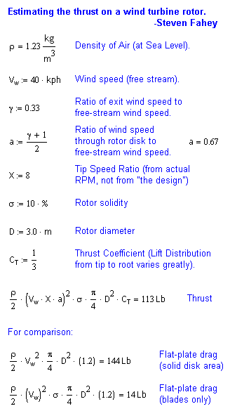

Sure you can calculate something, but it takes several pages of algebra and an integration table to get the final number. I worked on this problem all spring, in fact, and I'm still not sure I'm in the ballpark. What I do have is really fancy, and it spits out lots of nice info at the bottom. After a lot of work, I still need to do validation tests (like what you are doing) to prove that the math is correct. GIGO, you know...
Last night I did take a stab at making a rough "plug-and-chug" formula, but again, all I have to check it against is a bunch of other un-checked notes.
By trying to skip the steps of finding angle of attack and Reynolds Number at multiple points along the span of the blade, the formula is simpler, but you might be able to fool it by putting in data out of the expected range.
The graphic is a screen shot from MathCAD. The result jives with my more elaborate version for the data I entered. I tried playing with the diameter and wind speed, still good comparisons.
I used sea level air density, 3 meter diameter blades, 40 kph wind, and a 10% rotor solidity (the blades cover 10% of the surface area of the whole circle). I also needed to consider tip speed ratio, because the rotating motion of the blades make a lot of the thrust. The thrust coefficient takes into account that the tips make more thrust than the roots. Ratio of the wind speed going in and going out is a bit of a nuance - are you familiar with this fact? To use it, you have to know this:
Cp = 0, then gamma=1 (no power captured)
Cp = 0.3, gamma = approx 0.5 (typical power)
Cp = 0.59, gamma = 0.333 (at Betz limit)
In high winds, some windmills have high TSR before furling, in others it slows or can even stall-regulate. I assumed TSR=8 as a reasonable rough number. I've seen 10 or 12 on mine.
I just noticed that I went off the metric system at the end. Kilogram isn't a force, must have been a default for units of force.
