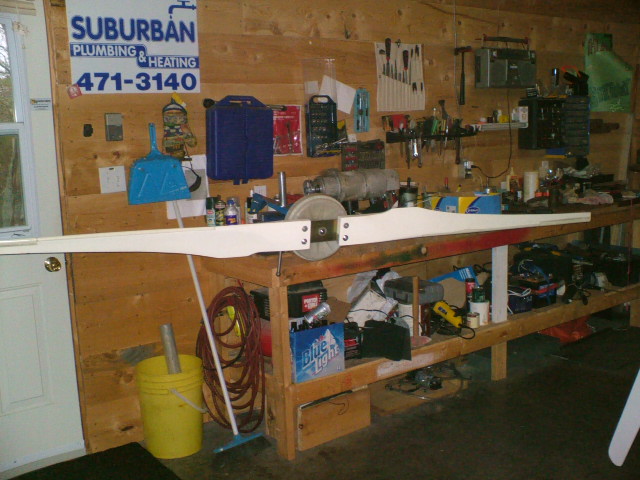

Thanks for the reply's so now I'll put a few coats on and get up and spinning.I have a 9',2 blade set that I'm going to try and post some results when I get them.
