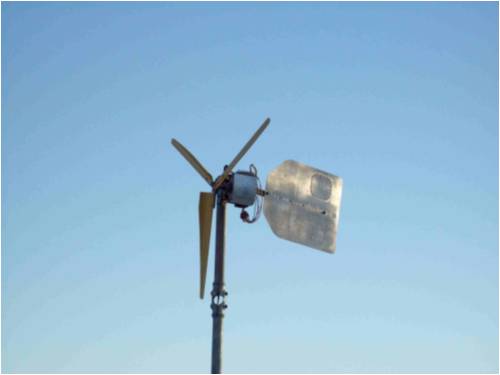

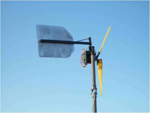

This is my first attempt at a generator of any size. It has a 1.1 metre blade diameter using pvc. The gentle annie motor is wired up using the high impedance windings and connected in delta. Bridge rectifiers mounted on top and dc wiring down thru mast. I'm having some trouble with the yawing side of things and it doesn't track the wind well until wind is strong. The gentle annie motor is bad for cogging but I didn't want this generator to run all the time (only charging battery for jump starting)so not a huge problem. I'm happy with it as a first attempt but I'm learning so I'll make some improvements for my next generator. I spent only $10 all up so I'm happy.

Extend the tail back another foot or so, and this will help with the pivot into the wind. Is this furling?, the design looks like it will move (If winds arent too strong out there, then you may not need furling. I used mine for months without any furling at all).
Also note your blades may be too close to the pole. PVC can flex especially under strong wind, so best to move them forward a bit. Try a bigger blade set as well for more power -remember, the higher the blade sweep area, the more power can go into your motor. Mine is about 2.2metres.

Thanks for the feedback Rob. The tail is furling but I have locked it up so it doesn't. I'll extend the tail and see how it goes. Will make some bigger blades so it starts a little easier. The alternator is mounted forward of the mast so the blades shouldn't hit the mast. I think it's just the angle of the photo. I'll give a 1 metre blade design a go so diameter should be similar to what you suggest.

What voltage output are you getting? Is this an alternator from a car ? as most alternators wont get enough rpm for the right volts.
Larger blades (I used 12 inch pvc pipe for mine), help out very well. but it will be a compromise between wind capture area, and weight. I remember finding my pvc, halfway in the dirt in a muddy backyard. I wasn't sure if it was sewerage I was washing out, or not.

I agree with robbo, the tail needs to go further back to make the windmill stable, especially in light winds. An extra foot would make all the difference, but go for 2 just to be sure
