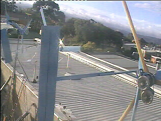

Still got to paint the blades, make bigger hub extensions , a guard over  the belt  and adjust the clutch cut in pot, my most advanced mill named after bobn R.I.P.

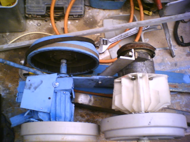

It has a 100 s delta (lo cut in low amps 14amps  at 12 v for lo wind around 60% efficient) on a direct drive shaft which uses flat belt on a  grooved magnetic ring it has a 2 to 1 ratio to a car air conditioning clutch on the front of the other f/p 80p series (hi cut in 42 + amps around 90 % efficient minus belt loss for hi wind) , with spring tension on pivot. On a 3 inch pole with a smaller square tube inside and bolt through it to support the sealed Bearing (like a car tire on aaroundabout) riding on a 3 inch pole /yaw.
It has 2 , 3phase rectifiers and a single 1 phase  rectifier to power the clutch from the direct drive alt. it simply goes through a pot to a capacitor ( to stop the bounce )and then to a super low current relay, To switch the 2 amps to the clutch and engage the second alternator,  In hi wind.

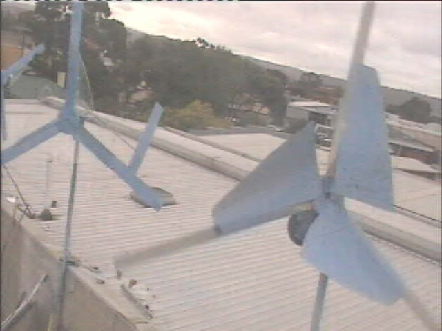

Posted: 09:06am 30 Apr 2006
Hi Adelaide
Can you tell us something about your blades? They look very narrow at the root compared to what we're used to seeing. I assume they're fairly high speed?

Posted: 11:15pm 30 Apr 2006
I have experimented with lots of props and think the angle is the most important thing   Here is a link to the blade calculator that I frequently use.
http://www.alton-moore.net/wind_calculations.html
I personally go with the width (cord) of 2 blades on 3 blades these angles seems to be the best ( on 3 blade prop).
My props are just thick wood that was available , I will add bigger hub extensions to the blades, these are tin, glued and screwed at front root to give the f/p much needed starting talk. Those that you see on the blades at moment, Were what was laying around and I will make them 3 times bigger shortly.
It works well and makes a clicking sound when the clutch engages or disengages.
When the clutch is engaged the bottom alternator is moving a lot faster.
Just great fun to watch the amp meter
Have fun.

Posted: 11:15pm 01 May 2006
got asked to post few closer pics this is it 1/2 done

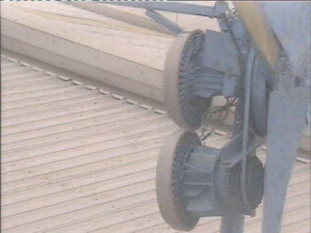

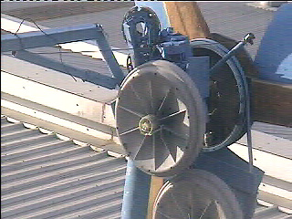

Posted: 11:31pm 03 May 2006
Here are a few more lo quality (sorry)of roof cam pics with the bigger hub/ root extensions installed ,wow so much more talk ,wood is varnished and I have tried to paint it all blue but it always rains a few hours later washing it off hahah , just need to add a few diodes to clutch the trigger relay so as to cut in a little later and I will be happy with that setup
