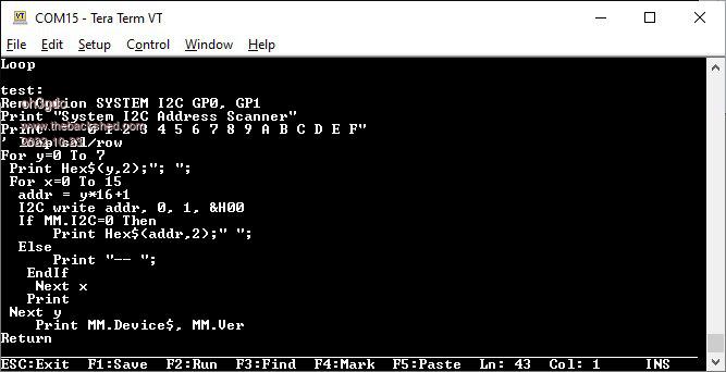

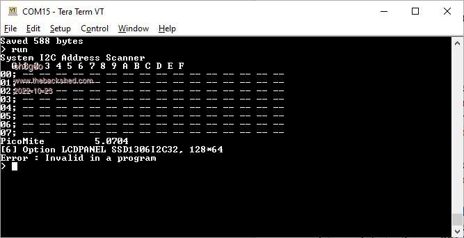

Then I did the I2C program to find the I2C address.
When I run the program,
I got this
I have no 10k upload resistors to 3.3V.
I tested the other LCD, but the result was the same
Pekka
Posts: 3412
Posted: 11:53am 23 Oct 2022
The initial setup of
OPTION SYSTEM I2C GP0, GP1
OPTION LCDPANEL SSD1306I2C, L, 0
is done once and must be done at the command prompt, not in a program.
It is saved in flash memory and remains resident.
To see what Options have been saved, at the command prompt type OPTION LIST
The output should include:-
The System I2C Address Scanner should then show address 3C
Posts: 10071
Posted: 12:58pm 23 Oct 2022
The "128*64" part of the command tacked on the end of line 6, is invalid syntax also.
There are two commands you can use - OPTION LCDPANEL SSD1306I2C for the 128*64 resolution, or OPTION LCDPANEL SSD1306I2C32 for the 128*32 resolution.
See PicoMite manual, page 43 and 44.

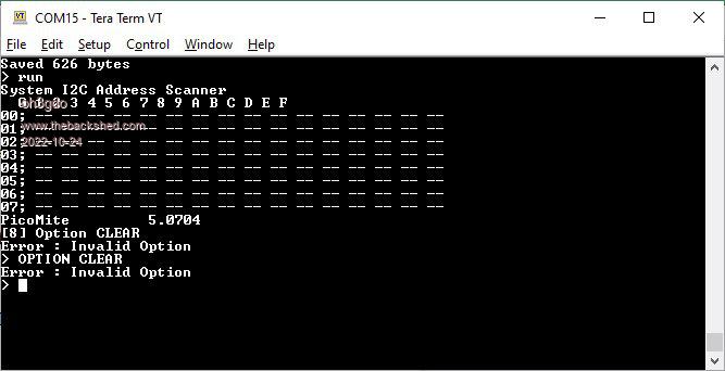

Posted: 05:46pm 23 Oct 2022
I found OPTION CLEAR from manual, but it didn't work.
Pekka
Posts: 6624
Posted: 08:38pm 23 Oct 2022
Please ask your questions in thew correct sub-forum. WE don't all look here...
To clear options
OPTION RESET

Your output from the Address Scanner does not show any I2C device, so you must get that sorted out first.
Are GP0, GP1, 3.3V and Ground all connected to the right pins? Check with a multimeter.
As OPTION SYSTEM I2C GP0, GP1 does show after OPTION LIST there must be an error somewhere else.
If there is a mistake remove it with
OPTION SYSTEM I2C DISABLE. Then type
OPTION SYSTEM I2C GP0, GP1 <Enter>
Individual Options can only be changed by first deleting the old one.
OPTION LCDPANEL DISABLE
Then
OPTION LCDPANEL SSD1306I2C, L, 0 <Enter>
Type OPTION LIST <Enter> again to make sure it is all correct.

That you can get something on the LCD is good news, though why the address scanner doesn't show anything is a puzzle.
Edit. Just noticed you have a typo in your picture of the scanner
  addr = y*16+1
should be
  addr = y*16+x               ' calc address
