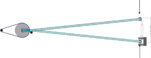

Posted: 01:01am 30 Jan 2009
here is a quick rendering to show to objective.
