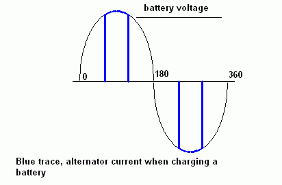

For clarity I am looking at just one phase and this is how the voltage would look if we had a purely resistive load and there was no inductance or capacitance in the picture.
This is how I think the current would look in our ideal alternator connected to charge a battery. In this example current only flows for about 30 degrees each half cycle, or 33% of the time. If our charge meter shows 10 amps (for example) the actual average current flow during that 30 degrees is 30 amps! Current flow through a conductor (in this case the stator coils) always incurs a loss due to resistance which is according to a square law. Furthermore, in the case of stator coils more current means more magnetic field being created and hence iron losses.

OK Gill, it is rather difficult to describe something I dont (yet?) fully understand, but here goes..
In my single phase example which is a perfect system with no inductance and no capacitance the alternator is turning at some speed where the peak voltage is only just a little above battery voltage, so it is only the peak voltage period that charges the battery. Lets say this peak volts period is only 30 degrees of each half cycle, or in other words only 33.3% of the time does current flow in the stator.
Now assuming that our DC charging meter shows 10 amps, this is the average of the charging current which is in really only flowing for a third of the time and so the actual current, during the short time that it does flow is actually 30 amps.
Supposing the stator resistance is 5 Ohms, our actual, short time, current is 30 amps, power lost in the stator resistance is 30x30x5 =4500 Watts! But only for a third of the time so over time the power lost in stator resistance is 4500/3=1500 watts.
However, if by some magic we could get 10 amps of current flow over the full cycle the loss would be quite different.. 10x10x5=500Watts, a saving of 1500-500=1000Watts!
Of course we cant get current flow over the entire 360 degrees but we might be able to do better than wasting 1000Watts.
Does this make sense?
