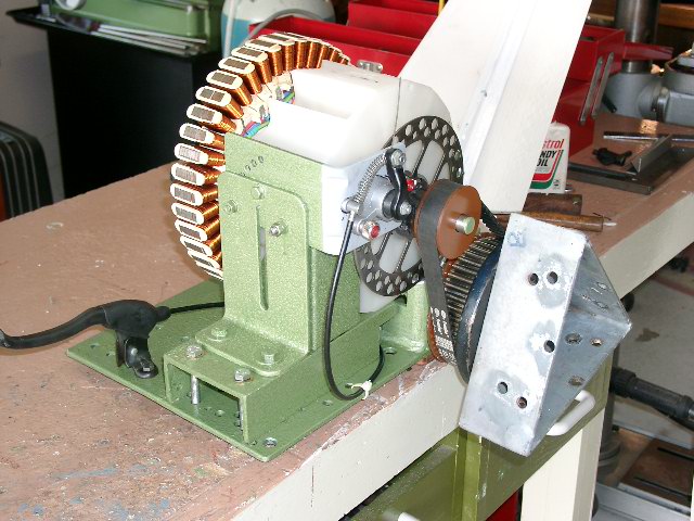

Try this -it worked for me .   I rigged the disc brake  caliper with a fishing line down the tower-pulled it to stop the mill --chatters a bit when pulled on at first but once th emill slows it stops it .
I'd go for a motorcycle one next time- a bit beefier--

But on a system that your building, it wouldnt be too difficult to implement the disc brake system. With the F&P system, like glenns and most others. There seems to be alot of shaft room between the prop and the stator. You could fit it there.
