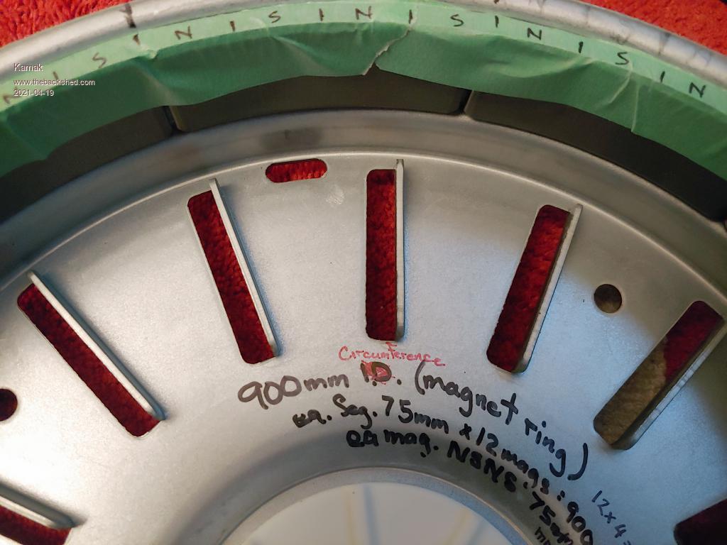

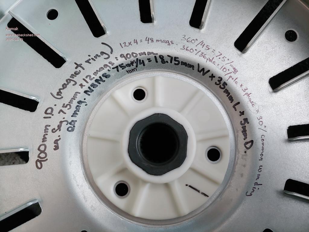

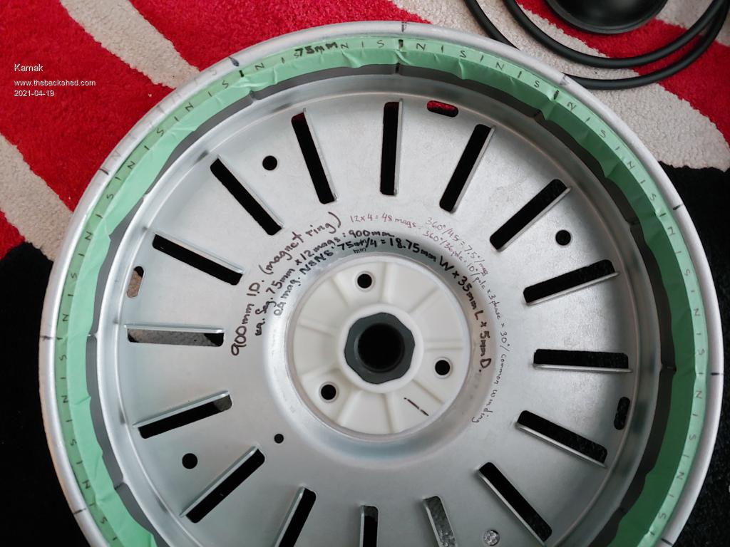

Stock Samsung P/N: 09CA49132 Stator
900mm ID. Mag ring
75mm W x 35mm L x 5mm Thk mag bricks
12 mag bricks
4 poles per mag brick NSNS
75mm/4 = 18.75mm W magnets
35mm L x 18.75mm W x 5mm Thk per mag pole
48 mag poles @ 7.5deg per pole, 15deg per "like" polarity
Stock mag flux density = approx 1750/1800 Gauss
36 coil poles = 360deg/36 = 10deg per coil pole
3 phase winding XYZ = 30deg per "common" phase winding
15deg per mag pole of "like" magnet polarity
therefore the "like" magnetic pole polarities (and transitions thereof) will always aline with the "common" coil windings throughout rotation, as 15deg is an even common denominator of 30deg.
Edited 2021-04-19 06:08 by Kamak
900mm [Internal Circumference]. Mag ring
12 mag bricks
