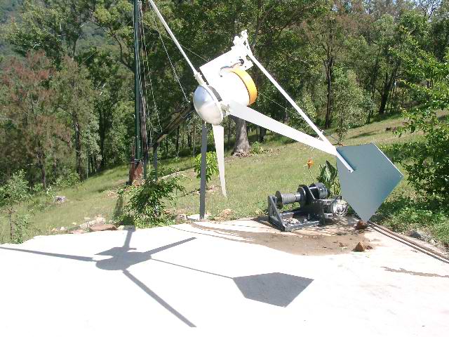

I finally raised my new 7 foot f/g blades on a single F&P complete with narcelle and nose cone -spiffy- ,Yesterday 120kph winds , today , not a breeze .
Anyhow , it looks like a goer , but we'll have to wait .

Looks good mate. Any wind yet? Would be good to see how those blades perform.

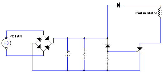

The idea of kick starting has been raised before. It is worth looking into, but I dont think anyone has tried it yet. I thought about mounting a modified cooling fan from a PC power supply on the windmill, and use this to charge a capacitor ( say 100,000uF ). When the cap reaches 30 odd volts, dump this via a SCR into one of the phases. A kick in either direction works, if its kicked the wrong way it quickly changes direction.
The circuit could be simple. 30 volt zenner diode on the gate of the SCR, and a diode to stop the mill feeding AC back into the capacitor.
Dont know if this would work.

The cooling fans have to be pulled apart and the little circuit board modified, basically just ripping out the switching transistors and connecting the windings to the output leads. They make a lot of volts ( stick it out the window of your car at 60kmh and your get 300+ volts ! ), but little current. Thats the idea in my circuit, the cap charges slowly, over a few minutes even, then is dumped in one hit across the a F&P phase.
The kick on one phase is like giving the tower a shake, a bit of a wobble and the windmill will start up.
Like you say, though, is it worth the effort, for only low power in low winds. But if every amp counts, then yes it would be.
