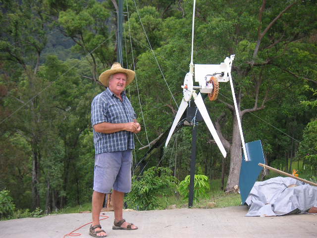

  I just balanced my set of new fibre injected blades yesterday- pic attached-
Important point --remove the rotor as the magnets will stop the mill from turning freely and you'll never balance it ...IMHO.
I added small nuts to the light arms til I got it stopping in "any" position . Takes a while ,but see if you can get it down onto a wall of your house or workshop on a dummy shaft , that makes it easier,or do as I did in the pic -lower the tower and prop the shaft so it's horizontal
But remember, you want dead still conditions--this mill is so light and so well balanced ,just a very light breeze got it spinning .
