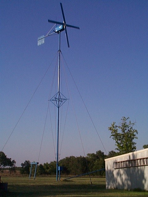

Breezy 5.5 (http://www.prairieturbines.com/) found that after extensive testing 4 blades did what they were after driving a 60hz alternator from a 60rpm blade set.

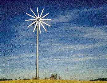

On the extreme end of things, Claus Nybroe from Windmission http://www.windmission.dk/index.htm found that for his particular combination of induction generator:rpm:diam, that lots was better and achieved a quite high rotor efficiency.
Windmission:
"In the theoretical windmill literature the maximum obtainable rotor efficiency is 0.6 . This is called the Betz efficiency, named after the man who calculated it on the basis of a rotor with an "infinite" number of blades.
The rotor efficiency is also named Cp, and in real life the highest obtainable Cp values are around 0.5.
The 12 bladed Windflower rotor, for example, operates with a measured maximum Cp value of 0.47, which is very good. "
His blades are as about as good as it gets, they are very quiet (250rpm I think) with good startup torque to drive a high ratio gearbox... a nice combination and a .47cp

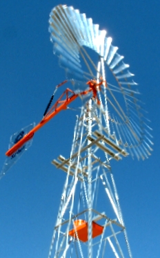

Turbex with a zillion blades works very well with a cp of .35 from memory. I think the South Africans did a bit better than Jacobs managed with the same type of setup.
http://www.turbex.co.za/Documents/Generator.html
5000 watts worth looks like this (18' rotor) Nice and slow (48rpm or so) and quiet.
and they go up to 20000watts. Not too shabby eh?

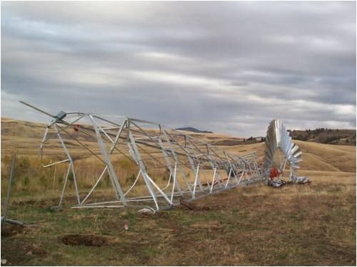

Of course, sometimes the blade number is not the most important detail to sweat over and some of the finer points need to be addressed:
(http://bob.gudgel.org/)
In general, 3 is the magic number... but with wind, not much is set in concrete.....it all depends on the alternator setup.
