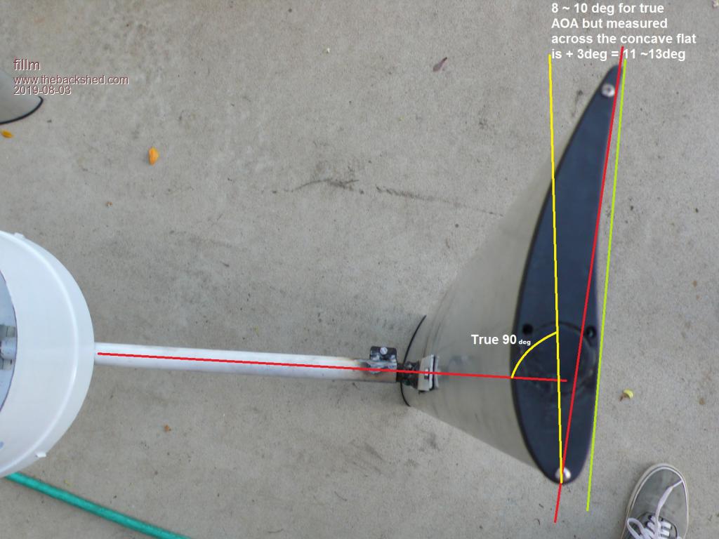

I am building a VAWT using the blade shape goe-222-iL. I have hunted for a sketch but can only find very elaborate calculations and all I need is a simple sketch showing how the blade/wing should lie on the radius. I have also noted that this subject has not attracted any comments for quite some time, any reason ?

Thanks Bruce, can't make more coffee, run out, need to buy more. Done many nights searching for the answerer, I know it's 8 degree but I need to know where to set the angle. As I said want to build the wings in fixed position, less to go wrong.
I could post a sketch of my understanding but then it might put other newbies at risk of getting it wrong. I did read a note where it was explained but now that I need it, just cannot find it.

it been a while but, the circumference line does not exist. the relation ship between radius line and the wing angle is everything. with the wing at an 8 degree angle there will be a different circumference at the front of the wing than the back. eds wing is not a 222 profile. i build drag mills but was part of a vawt forum Ed mentored. i recall lift type builders would often leave the connection of the vertical wings and the support structure adjustable because they were trying different profiles. someone on the back shed was selling aluminum goe 222 wings, i would guess they would know

Hi Fish,
Might be way late for this reply but have been tied up on a project I took on which has consumed most of this year.
Anyway below is a Pic of how I set up AOA and did a few tests on a VAWT / GOE blade angle years back. I will say my opinion of VAWTs as power makers is -5 on a scale of 1-10 .
