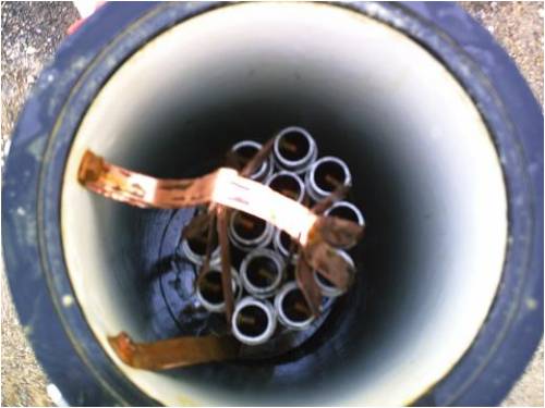

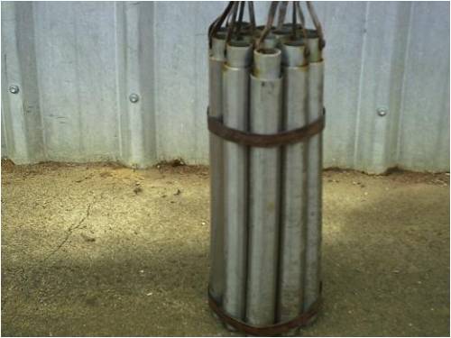

The electrolyser I built was made from food grade stainless steel pipe.
The inside pipe was about1.5mm thick and 25mm dia and the outside pipe fitted over the
inside with about 1mm clearance between and 300mm long. I cut bits of conduit to space the inner and outer pipes which I placed near each end and the oxygen and hydrogen form between the pipes so gaps must be left. I made 14 lengths of pipe and bundled them together by cutting a length of 12mm copper pipe in half long ways and then flattened it out but next time I will use lead flashing and cut it in strips. I connected all the out side pipes to the positive terminal and all the inside pipes to the negative terminal and placed the pipes in tap water. The bubbles just pored out between the pipes so I added a little detergent to trap the escaping bubbles and ignited it. The result was amazing, it went off like a shot gun. I suggest just make up one length and put some jumper leads on the pipes in a bucket of water. To reduce resistance in the water just add baking soda and that will increase the current. This design is great if your going to feed the gas straight into the motor but to store hydrogen the oxygen must be removed, so I need to do a re-think on the design.

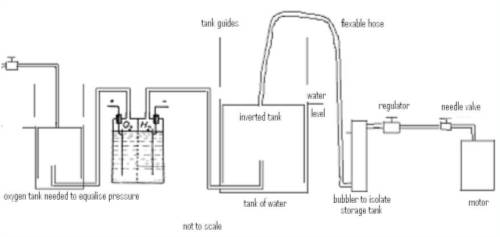

The picture below is a basic plan of the lay out. As the gas builds up in the tank it causes the top tank to lift. This idea has been used on natural gas as storage for a town also to store the gas off septic tanks and serves as a pressure relief valve . This makes it very safe as you must add oxygen and an ignition sources for hydrogen to burn. The bubbler is a small sealed container full of water. If the gas starts to burn back up the pipe from the motor this prevents the flame reaching the storage tank as the flame can not pass through the water. The pressure in the tank depends on the weight of the inverted tank.
My first Electrolyser
