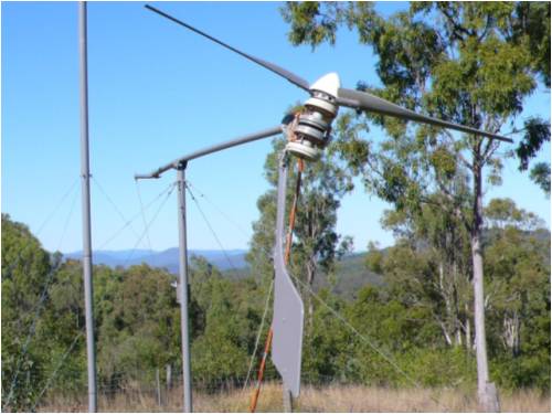

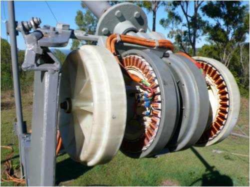

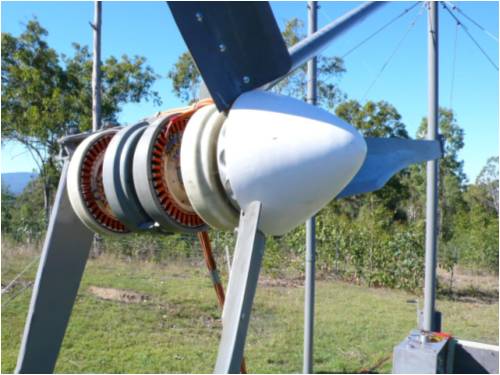

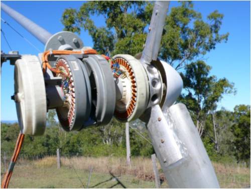

Hi ,
Thought I would throw a few pics of my latest mill I nic named " THE BEAST " . It is set up as 2 x 60s and 2 x 80s all unmodfied stators in delta , each has its own rectifier in parallel . Recently on my good wind days I have been watching my dual with 3.2m dia blades hitting 520 rpm and with the piclog data max power is at 350rpm for both 60 & 80 series and the cut in is 100rpm for 60s - 145rpm for 80s reaching max output 450w @ 400rpm for 60s and 550w @ 400 rpm for 80s , so I came to the conclusion I am powering a golf buggy with a V8!!
Anyway I can now alter cut in rpms by different stators / star delta / etc , basicly staggered stators with a potential output of 1kw with out the downfalls of neos which in my experience with them require to much start up force and come on to quick stalling the blades . With this set up I could for example have 4 different cut in speeds - 60 star @ 65rpm , 80star @ 87rpm , 60 delta @ 105 rpm , 80 delta @ 145rpm , but for first I am going all delta as my blades seem to start performing at 80 to 100rpm . Hopfully this will keep a gradual load on the blades to stop the over rev which is what I think is the cause of noise and failure in high winds.
Also by carefull alignment of the stators and rotors I have been able to reduce the clogging to a minimum , but there is more magnetic and mechanical drag to deal with . While sitting here it has just started for the first time in 13 to 14 k puffs and kept running in 8 to 10 k , which is promising .
Hopefully I haven't sacrificed to much of the low wind peformance I was starting to get with the dual 60s , but time will tell there and that definatly will be a down side .. The other down side is the head weighs in at 32kg add another 33kg for the pivot, tail and bump start blades and hub and thats why its called " THE BEAST "
Luckly I have a big strong 18 year old son to help me lift this on or I would have had to build a crane to lift it on!!!

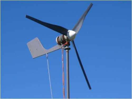

Blades on and ready to see if the tower will bend..
Another pic just in case it ends up a twisted mess on the ground!!!

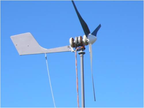

Going up , pole is handeling the load but is flexing a bit...
Up and waiting for wind !!!
" THE BEAST "

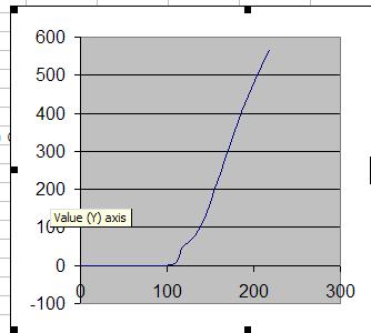

Still not a lot of wind but we have had a few blows that the piclog catches the data , as Kim turns it on if the wind starts as I am now working in Brisbane , anyway here's some figures that look promising
RPM - Watts
105 - 3 - cut-in
117 - 45
126 - 63
140 - 106
162 - 240 - 80series stators cut in @ 145rpm
186 - 405
218 - 569 - wind speed was 28 klm
It definatly takes 12 klm to start and will keep going in 8 to 10 klm as long as it gets above 50 rpm , can't wait to see 30 to 40 klm , hope fully sooner rather than later. Would love to trial a set of your big blades on this gen . I'm also thinking of knocking up another 3 blades and trialing 6 blades to improve the low wind output as by the look of the data so far by 300 rpm I should be getting close to 1Kw . Time and wind will tell..... Phill

Hi Phill,
I have plotted the data, you presented.
The graph does appear to be quite linear. This is not what I would have expected. This may be caused by some relation between the iron and rotor. Good output whatever the case.
I will be bringing my cct bits to QLD, with some rewinds to be tested at Bruces. Good luck tonight. Gordon.
